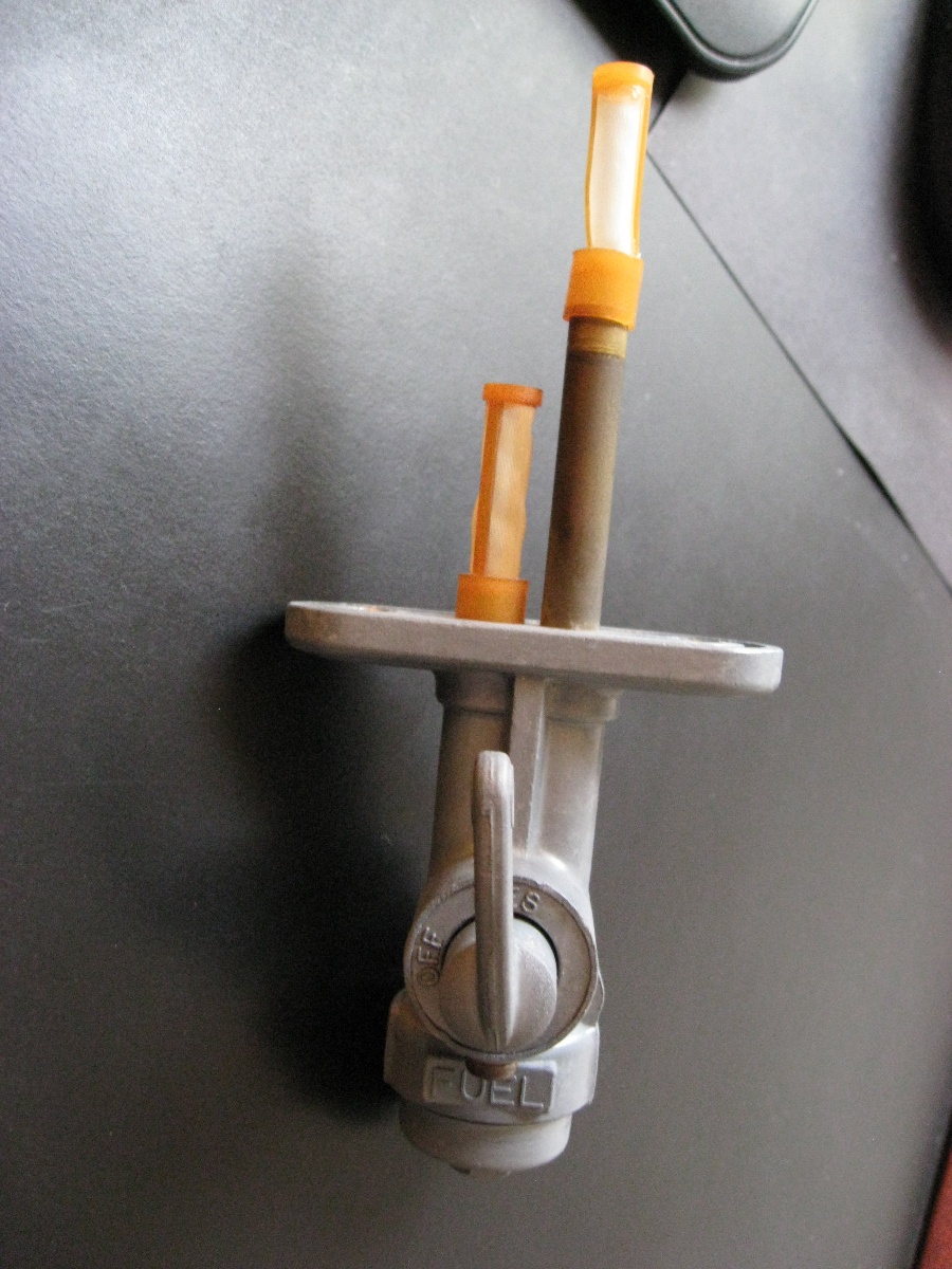

Here's a picture of the original 1977 KZ650 petcock. It was made differently than the one on your bike and it had 3 positions - ON; OFF, RES (reserve). Ed
I see. I currently dont have a petcock with and off position. So what should it be put at when parked according to my petcock? On Prime or RES

M_a_t_t wrote: You want it on "on". Petcocks that dont have an off position are vacuum operated. Prime just opens the petcock for full flow. On and reserve are vacuum actuated so it will "shutoff" when the engine is stopped.
Ah thanks so much. Thats probably why it flooded

The first type is the one I have (see photo) that has "RUN; OFF; and RES (reserve) positions. This petcock has a single fuel hose that connects to a center "T" fitting between the #2 and #3 carbs. When the bike is parked it is best to put that type in the "OFF" position. When running the engine the petcock should be in the RUN position, and when very low on fuel it should be switched to RESERVE.
The second petcock type is vacuum actuated. It has 2 hoses. The fuel delivery hose connects to a center "T" fitting between the #2 and #3 carbs, and the other hose which is for vacuum connects to the nipple on the #2 carb toward the front of the carb. This type petcock has RUN; PRI (prime); and RES (reserve) positions. This type petcock relies on vacuum from the #2 cylinder/carb to pull on a diaphragm inside the carb and permit fuel to flow when the engine is running when the petcock is in the RUN position. When the engine is off the lack of vacuum lets the diaphragm relax and this in turn shuts off fuel flow (unless the diaphragm has a problem). The RESERVE setting is used when the bike is low on fuel, and the PRIME setting is used if the bike has been sitting for an extended period and there is not enough fuel in the carbs to start the engine.
If your petcock is the second type where does the vacuum hose attach at the carbs? The 1977 Mikuni carbs did not have the nipple for the vacuum type petcock, but it is my understanding that some folks who wanted to use a vacuum operated petcock on the early carbs hooked the vacuum hose to a nipple on one of the carb holders. I wouldn't do that; I would just buy the correct petcock. Ed

I don't know that the above advice is true or not for your particular bike. The 1977 KZ650 came with Mikuni VM24SS carbs that do NOT have the vacuum nipple for attaching the vacuum operated petcock. If your petcock is the vacuum operated type where is the vacuum hose attached at the carbs? If your petcock is the later vacuum operated type did someone install later carbs; did they attach the vacuum line to a different nipple; or what? Ed
BTW Z1 lists the KZ65-B1 petcock (which I have) as OEM vacuum operated.
If that is true then the Z1 website is showing bogus information. The KZ650-B1 did NOT come with a vacuum operated petcock. Take a look at #10 in the link below if you doubt me. Ed
www.powersportswarehouse.com/p/Kawasaki#...50-B1-1977/070076F-8
