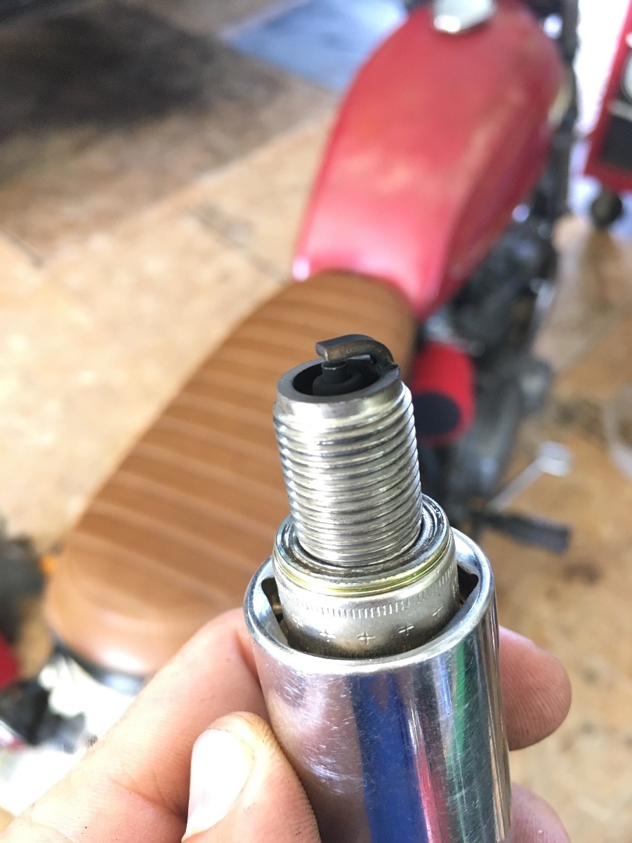

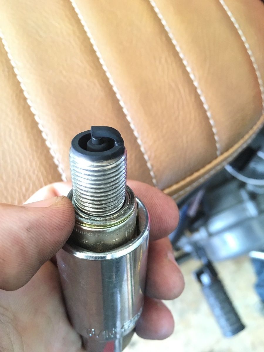

Here's the latest: My jets have been 200 main 25 pilot. I knew 200 was too big but I figured I would get to that when it could actually hold an idle (wrong?). Today I threw in a 140 main and it seemed to do better at idle (I think). Here is plug after running for a while (very unscientifically) with the 200 and the after with the 140. Seems better right?
STILL have racing idle that will drop down to a chunky, uneven idle when I crack the throttle, but if I give it gas gradually and release, rpms hang or even climb until I blip it again.
Triple checked float height, its fine.
