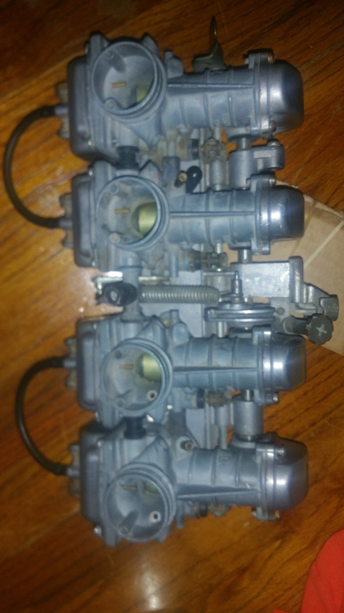

The hunt for the airbox is becoming a bit tiresome and so far no luck with the current one. Since I have the option I'd like to use pods with the tk22 at least until I can get a hold of the right airbox.
Sidenote: I think I might have screwed myself. Bought these carbs from a seller who claimed that they were off of a kz550 c Ltd. However these are not tks they are mikuni.
Can anyone identify these carbs?

Mikuni VM24 is my guess.

Thanks lou, I call bs that they came off a 550.
His words "Ya it came off a kz550 i had. They would have to be cross compatible. I just ride them to test them out and part them going off what vin#s say so not sure on teikei carburetors being only ones on the kz"
Going to ask for this so called vin#... measured inside bore on engine side and got around 25mm.

I don't know my 650 carbs too well, but I think that's what they are.
All Kz550's use TK carbs. Even the Zx550 uses TK carbs. I think Zr550 might also use Tk carbs as well, but that will need confirmation. But for sure, no 550 used those carbs you have.
All you have to do is compare the center-to-center spacing. 550 carbs are closer together than the 650/900 carbs.

Yeah shame about the spacing as it is off by just a smaller amount when I tried putting them on the head . I'm going to try and get a refund. Careless careless careless mistake, I will try and find a set of tk carbs

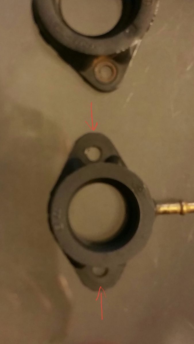

Just wanted to make sure I am getting this since there is no room for any mistakes
. I am making the slot from the screw hole to the outer edge as indicated in the picture, correct?

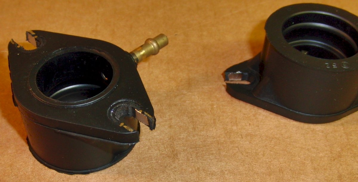

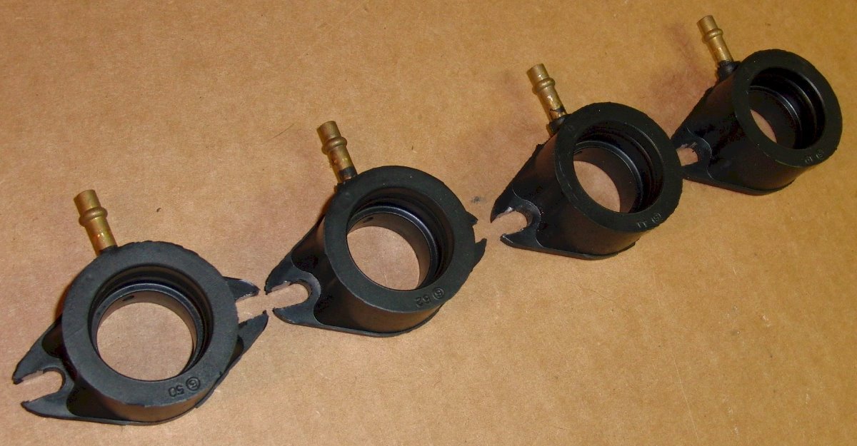

Yes that is where to cut, but I did not grind off the rubber. You don't want the rubber to start peeling off if you can help it.
I cut the slots a little narrower than the hole diameter to leave as much metal as possible for strength. Then I used a metal washer that was 2.5mm thick, with an OD of 15mm. 14mm might have been better to give a little more play for centering the manifold.
I used all new stainless hex head bolts. I can't recall the length, though.

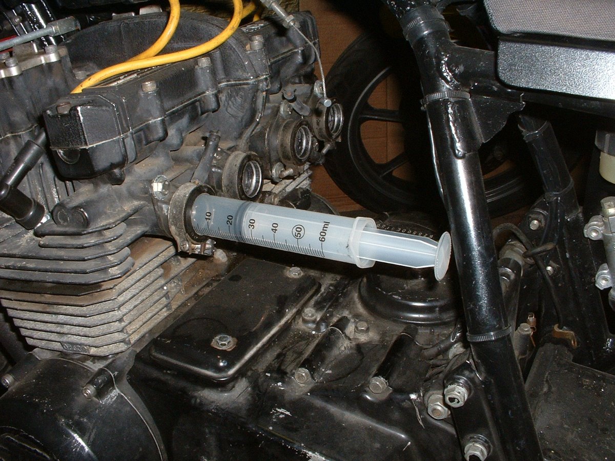

I used a syringe to check for vacuum leaks, but I think you can even get a vacuum leak through the valve seals so I don't know if this test is actually worth doing.
I use plugged fuel line for the vacuum caps. I find the typical auto-parts vacuum caps disintegrate quickly in this application due to fuel exposure.
