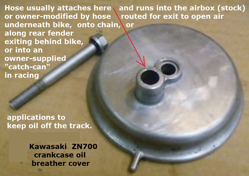

From the Kawasaki Service Manual (FSM)

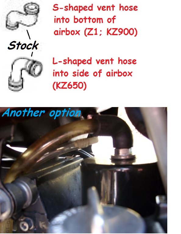

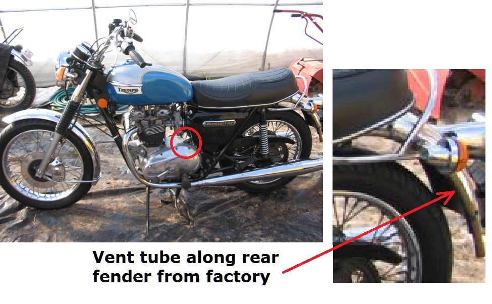

Here's one way the Brits did it
