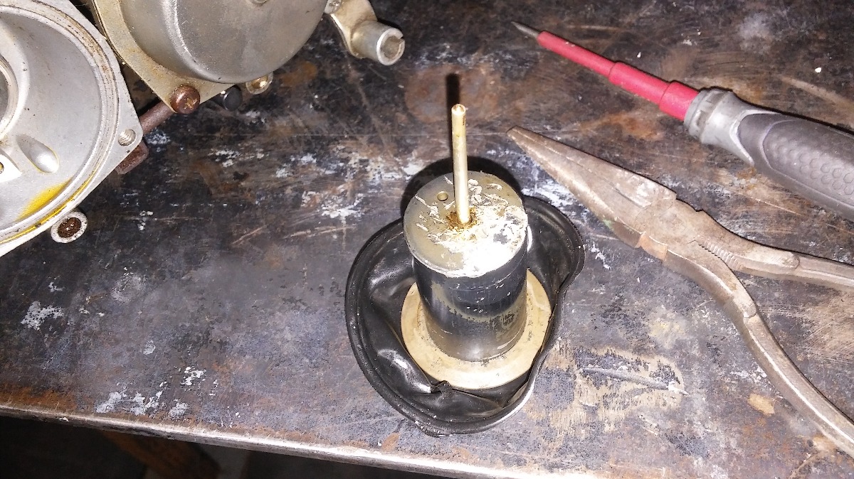

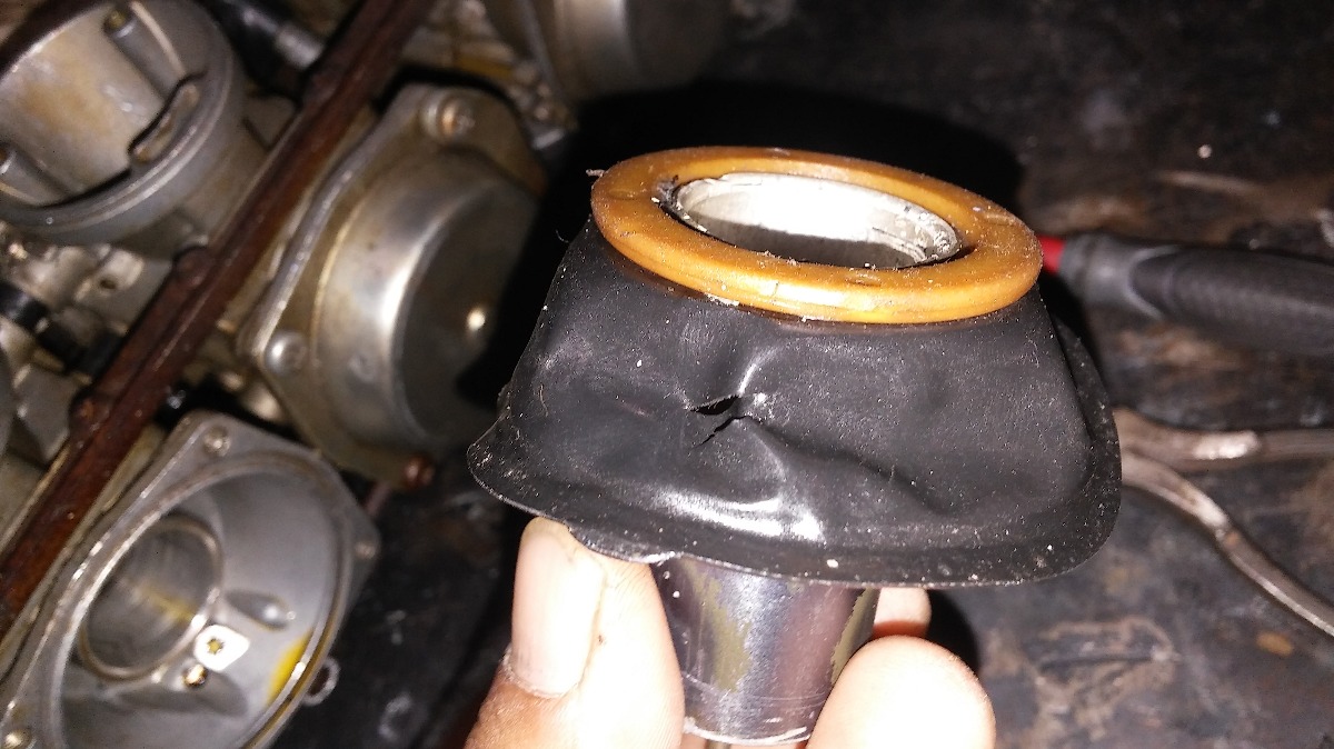

Hello guys and gals. New to the forum, and had already posted on the newbie section. I'm having an issue with the '81 csr650 I'm restoring. I need a set of mikuni carbs that work or may just need a little work for them to put on my bike to finally start her up. The carbs I have been tampered with and who ever did so messed up one of them bad plus they are clogged beyond belief. Any advice in what to use to soak them in? I'm going to need parts to try to fix them up so if anyone has something give me a shout please. I know that the throttle valve and needle on the #1(far right) are fubar. The needle is bent and the valve itself is gouged somewhat, I guess from someone prying on the thing to free it up. Everything else is just stuck with old gunk from old gas. The other carbs do go up and down (throttle valve) but stay up except on #4 that comes down by itself. So any help will be greatly appreciated because I have to get her going really soon because I have to give my brother his car back and I have no other means of transportation. Thanks and hope someone can help with something.

Thanks for the info Scirocco. Does anyone know what carbs would be a direct swap or good to scavenge parts from? I still need the throttle valve, needle and diaphragm for mine...

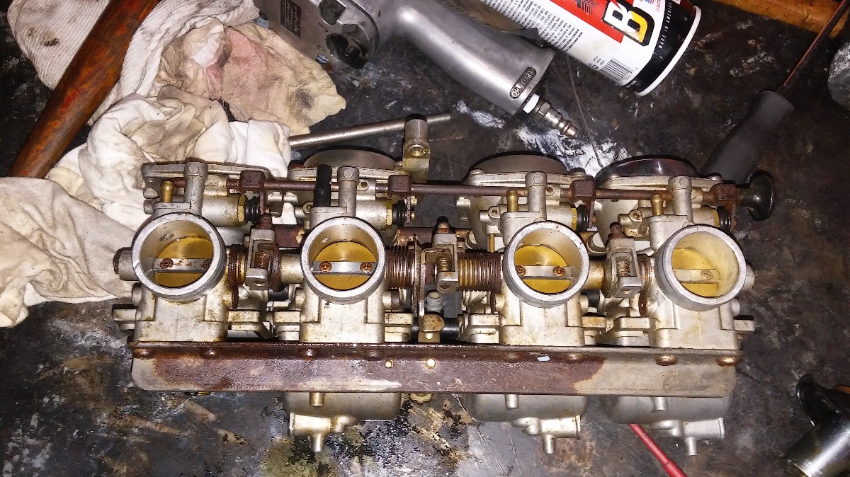

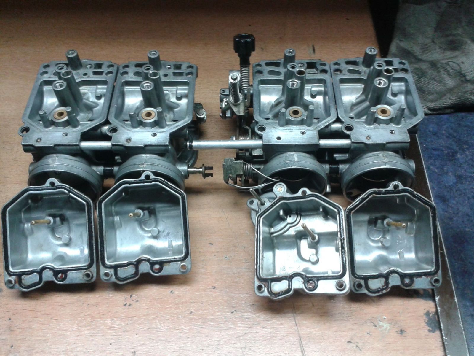

Can you upload some pics of you carbs
- turbospark
- Posts: 12
Re: Need csr650 carb help
23 Aug 2017 18:51
I will have to get some tomorrow in the morning and try to post them in the afternoon. I have to do some work with my father but will sure take some. As far as I can see they are the mikunis but can't remember the numbers. They should be the original ones. This bike is an '81 with only 13k miles....That's why I'm trying to get her going and have a cafe eventually.

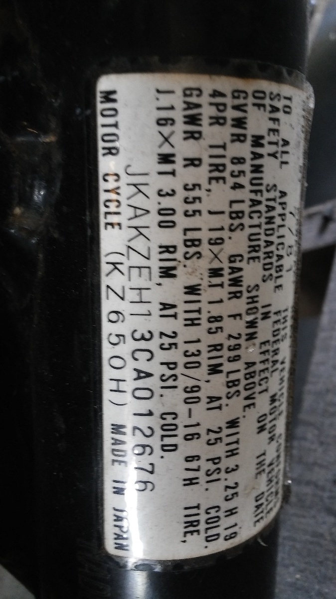

Are you certain the bike is an 81 model? I'm asking because the 82-83 650-CSRs came stock with BS32 carburetors.
You can check the vin & engine numbers at the jarlef z650 site. fyi. there's a pdf manual in the Files section.
note: the date of mfg listed on the vin label isn't necessarily the model year.
edit: from the vin label below the vin lookup at Kawasaki.com indicates that it's an 82 KZ650-H2.

here is the vin of the bike...info is appreciated but I believe is an 81.... It says 7/81 as the manufacured date up top

Your motorcycle is a fairly early 1982 KZ650-H2. The first 1982 KZ650-H2 VIN number was JKAKZEH1CA012601. Just like cars, motorcycle production for each model year begins in the previous model year. Otherwise in January there would be little or no new cars or bikes available at the dealer. See the bottom of the link below to verify the VIN / Model year & model. Ed
