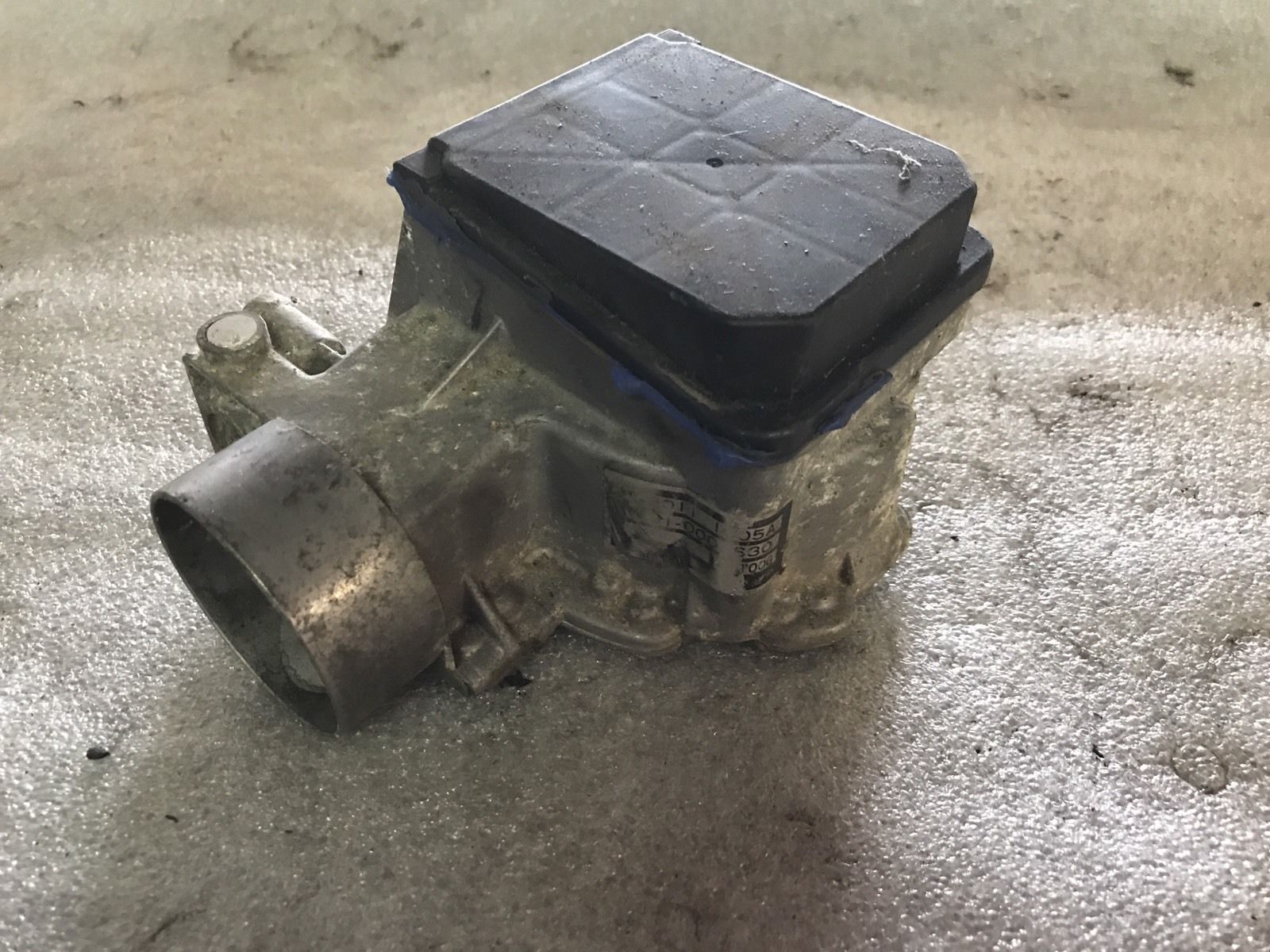

No eBay APP ID and/or Cert ID defined in Kunena configurationDOHC is right,the early EFI systems have a air flow meter and the injectors in the cylinder head

I'll can confirm the injector in head as shown in Scirocco's pics. Pic #2 cracks me up "Electronic Fuel Injection was always a good idea. Making it work was an even better one". A bit of irony there. The bike isn't in my garage yet. I'm wrapping up another project within the next week. So I can't pull plugs at this time. Originally I was planning on converting to carbs but you all have inspired me to battle with the FI.
