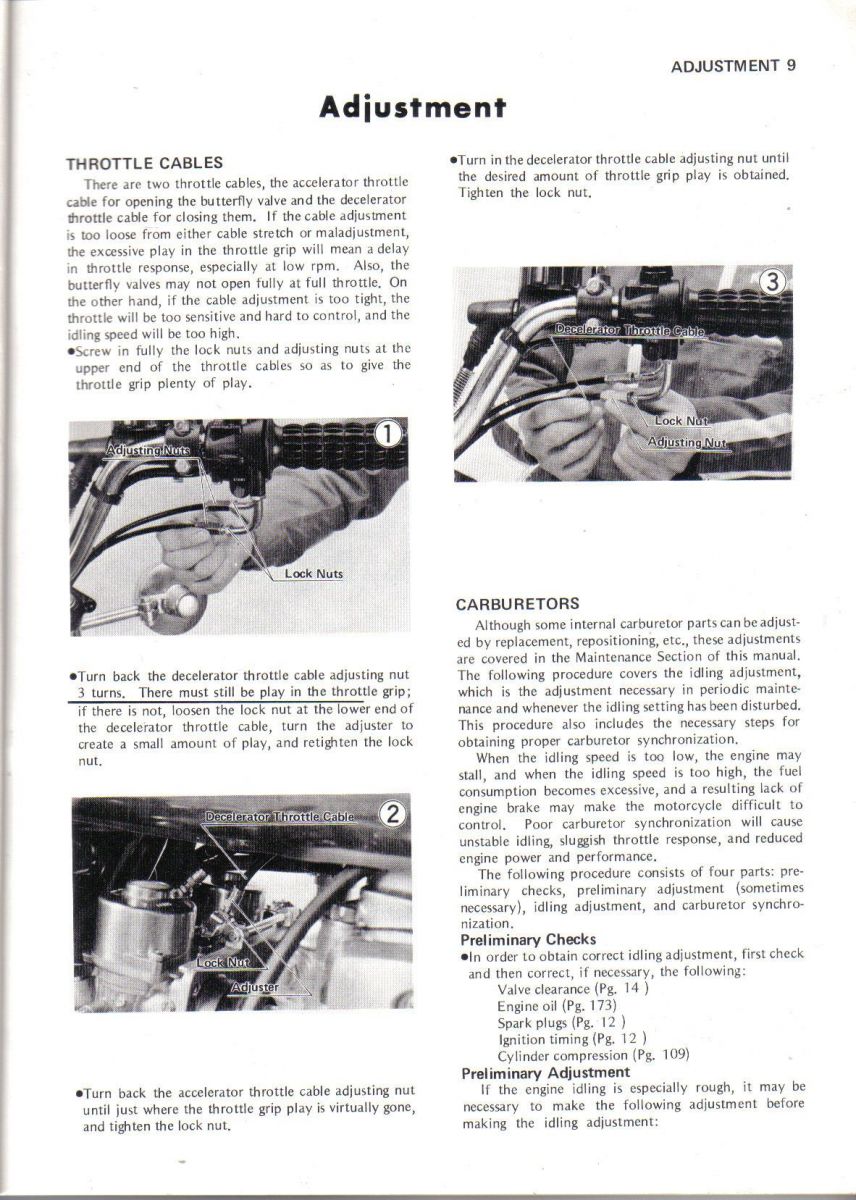

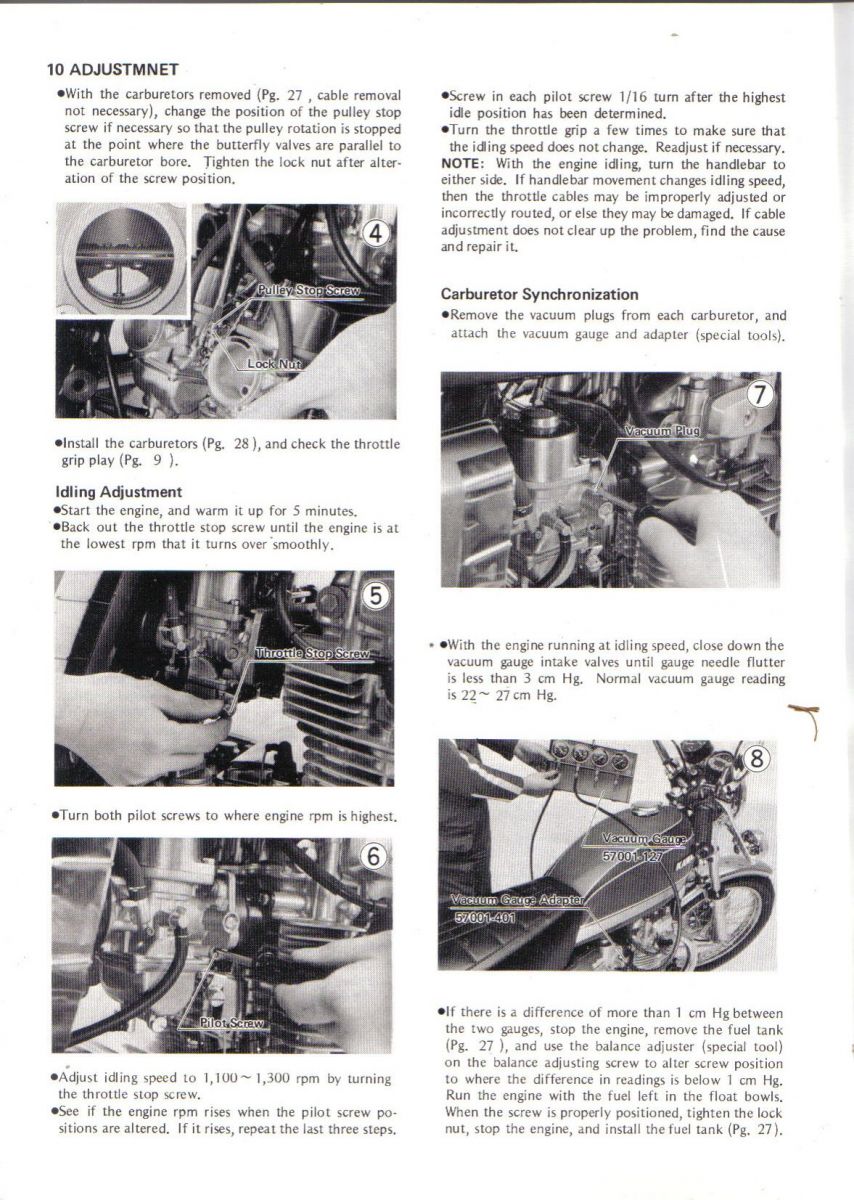

Are you sure the carb butterflies are really closed!
Have you maybe forgot some plugs?
Have you a service manual ?

When I have "bench synched" carbs like that, it is real easy to leave the engine idle setting way to high. Just turn it down and try again.

Yes butterfly's are closing. And I do have a service manual. 3 of em. And I tired to turn the idle screw down but it sputters and dies or shoots too high no in between. From what ive tried atleast
