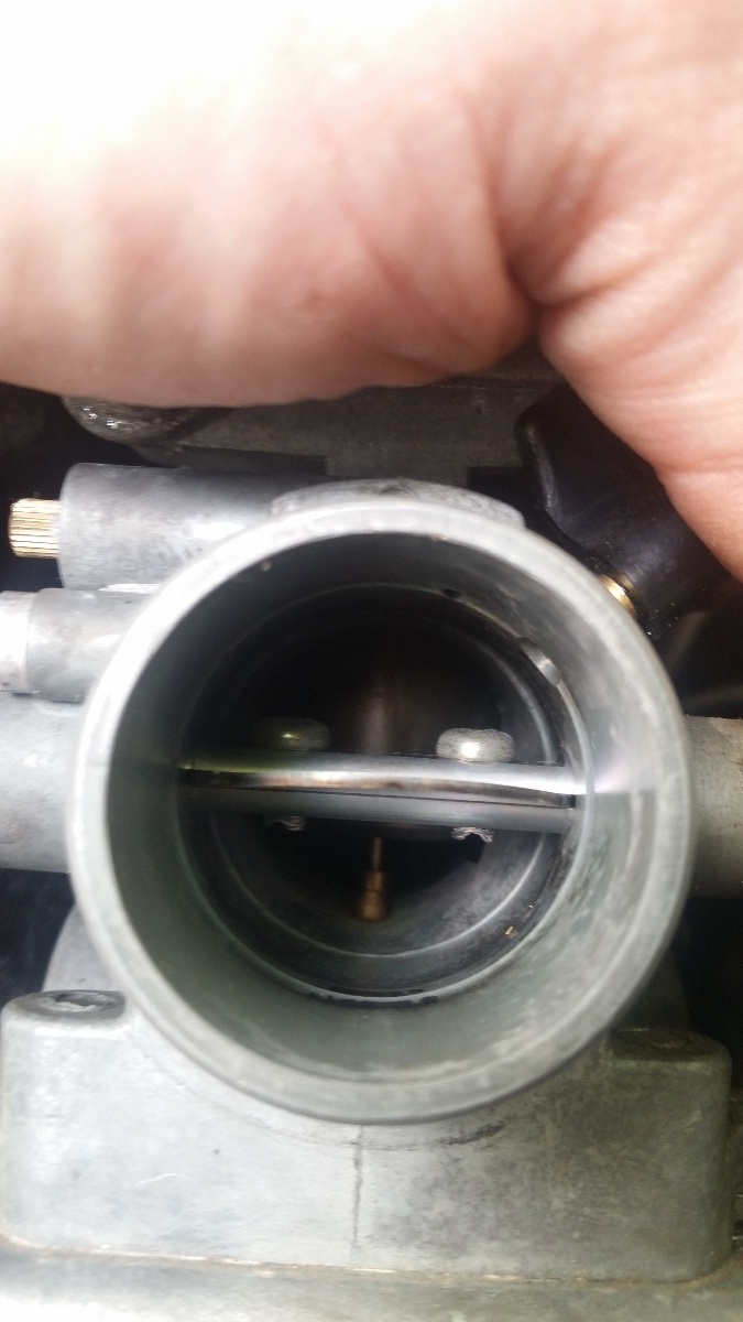

17 Jul 2017 16:31Does anybody know if you can bend back a butterfly valve? Or am I shit out of luck? I've tried searching for just a carb body or something but no luck. Any chance somebody here would've an extra kicking around somewere? Any info for a solution would be greatly appreciated.

Bend it back. You might need to remove it first. Use red loctite on the screws when you put it back and consider flaring the screws out in the back like they do when installing them at the factory.
