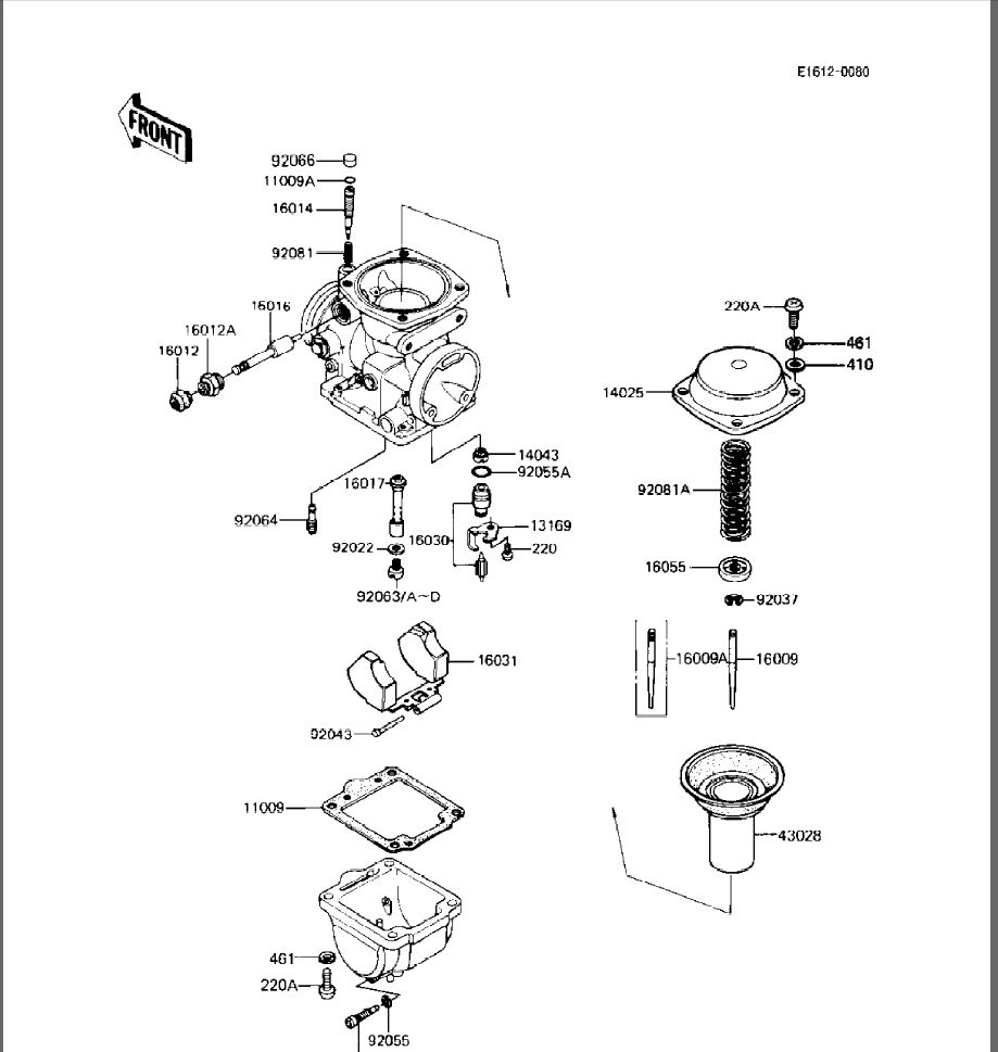

Bs34s on kz1000r2, I have ultra sonic cleaned ,put new Kawasaki pilot jets in ,but bike still misses. Pilot jets do not have plugs but parts catalogue does not list for this model.bike is slow coming off throttle and air screw adjustments have no effect,any ideas

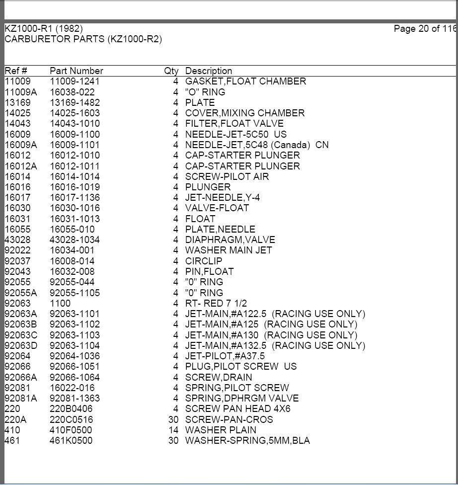

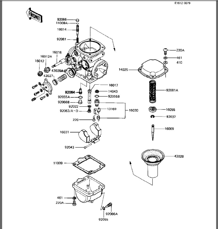

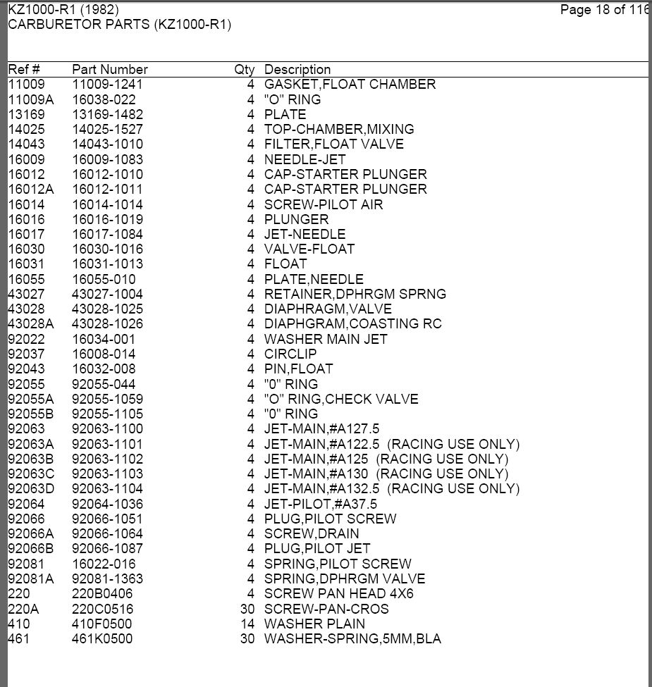

Yes of course in my parts list for the R1 model
Ref # 92066B
Part Number 92066-1087
Qty 4
Description PLUG,PILOT SCREW
Diagram and Parts list, see page' 17/18
Edit: R2 model
Michael
Ref # 92066B
Qty 4
Edit: R2 model
Michael
