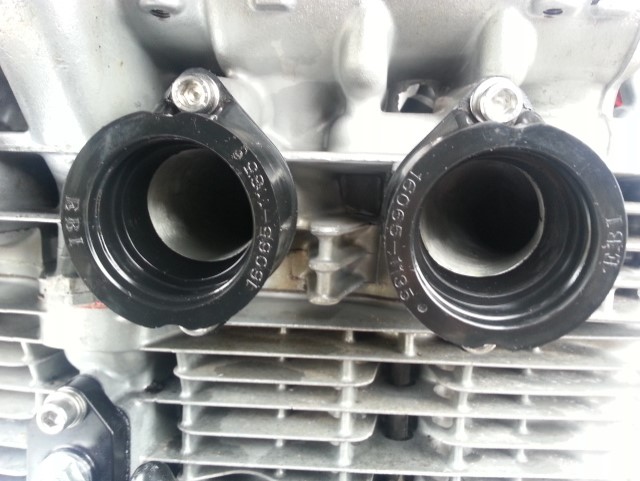

I may have installed the wrong boots. It looks like there's two versions of boots available for 34mm carbs. I'm not sure which one to order. My carbs are BS34ss.
16065-1131:
Equivalent to OEM: 16065-1131 16065-1066 Set of 4 intake manifolds - 34mm Carb bore size,40mm carb spigot diameter, 58mm between bolt hole centers, 25mm depth. Triangular groove approximately 1/8" from end of carb spigot.
Fits Kawasaki KZ1000-J3, KZ1000-R2, KZ1100-A3, KZ1100-D2, KZ1100-L1, ZN1100B, ZX1100A. See below for clamps. Use these carb holders when installing Keihin CR29, CR31, CR 33 carbs on these bikes.
11065-1035:
Equivalent to OEM: 16065-1135 16065-1036- Carb bore size 34mm, carb spigot diameter 40mm, 58mm between bolt hole centers. Radius style groove approximately 1/4" from end of spigot.
Fits Kawasaki KZ1000-J1, KZ1000-J2, KZ1000K, KZ1000M KZ1000P KZ1000-R1 KZ1100-A1 KZ1100-A2 KZ1100-B2 KZ1100-D1.
See below for clamps. Use these for RS34, RS36 or 33mm smoothbore carbs on these bikes.
16065-1131:
11065-1035:

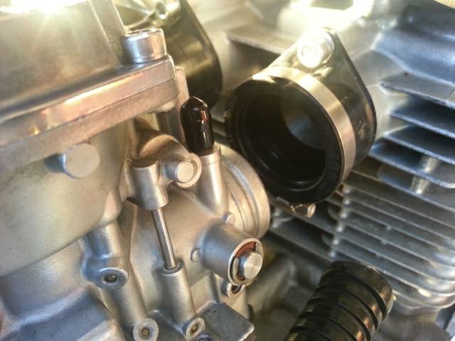

Today, I removed the boots and found that the rubber had separated from the flange on 3 of the boots. I think this is my problem. Does anyone have any suggestions on repairing the boots? or should I just order new ones?

- Posts: 15343
- Thanks: 2830
Re: Vacuum leaks at carbs
20 Jul 2017 13:57
Replace them. If you try to repair them you will be spending countless hours going over them again and again. Ed
The following user(s) said Thank You: loneagle
- Posts: 23318
- Thanks: 2864
20 Jul 2017 13:59
They look new from the outside but the first pic says otherwise. They should have conformed to the intakes. I'd buy new ones.
