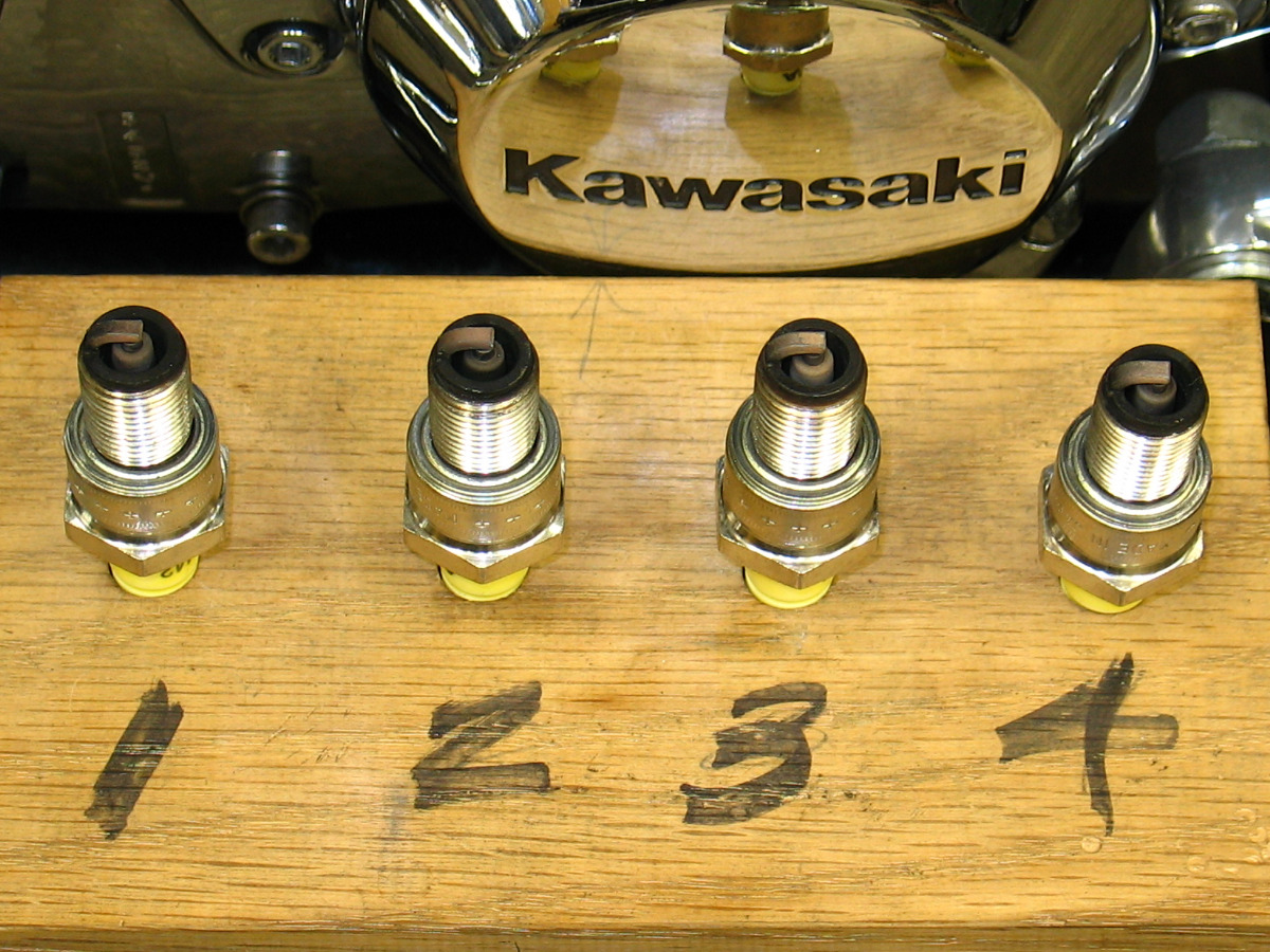

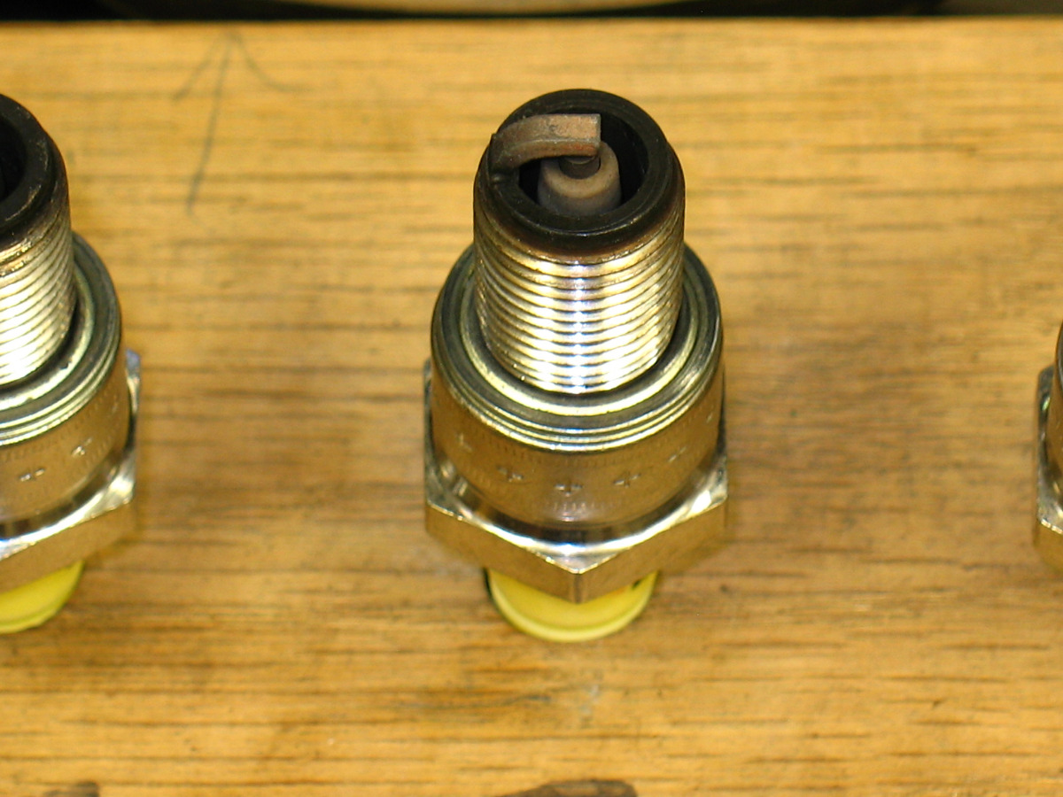

04 Jul 2017 12:43daveo wrote: I'll be using Rotella next oil change forward. Maybe the different formula will help the rings do their job better.
Changed a few things last night. She now has 17.5 Pilot Jets in place of 22.5's, with .8 Pilot Air jets vs. .9, and 125 Main Jets vs. 127.5
She ran very well on a brief test ride after the carbs were synched...and I also set the floats back to 17mm.
Will see how this setup works out for a bit.
Rotella T is amazing stuff! I used to put 15W40 Rotella T diesel in my 500 000 mile 86 Toyota 22RE 4 cyl. for summer. Oil consumption in that tired old engine dropped from a quart every month to nil from April to October, and when I drained it out after a summer of about 25 000 miles, it was still gold in color. The valve train never needed adjustment again, and the inside of the engine was really clean. I worked in a highway truck shop at the time, so Rotella T was next to free for me. Everyone warned me the Rotella T would ruin my gas engine in no time. If anything, it kept it alive for another 5 years past the point it should have died...rust finally got the best of that poor old truck. Four years after I parked it (still with the last Rotella T change in it), I went to move it and it started and ran like it had another 500 000 miles left in it. Only drawback - difficult to crank the engine when it got down to freezing temps...

06 Jul 2017 05:49SWest wrote: Dave and I have both achieved the elusive peanut butter color. Problem is when you make changes, (main jets) they affect the other circuits.
Update after trial and [strike]error[/strike] success!
:woohoo:
