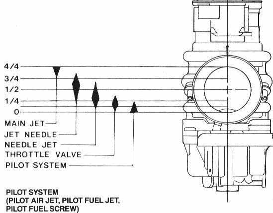

10 Jun 2017 15:02daveo wrote: Having a clear understanding of jetting and the relationship of carb circuits is crucial to achieving and maintaining a finely tuned engine...so I keep telling myself. :whistle:
According to the image text below, the [strike]Pilot[/strike] Air Jet directly affects the Main Needle Jet, not the Pilot Jet...duh. :blush:
Thought I was confused. Note the note (lower left) about the PILOT SYSTEM :S
:laugh:
