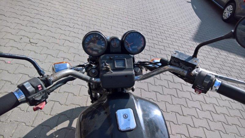

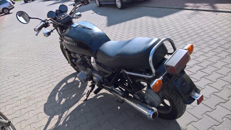

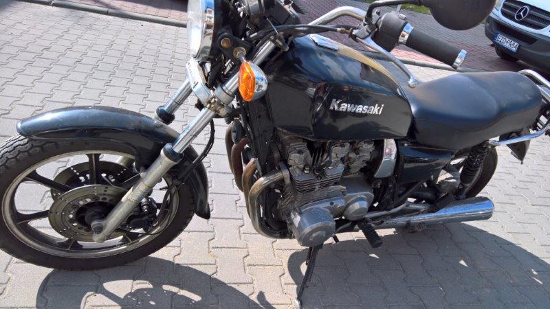

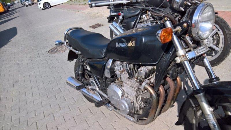

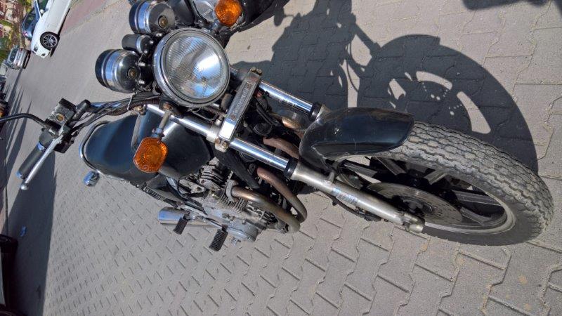

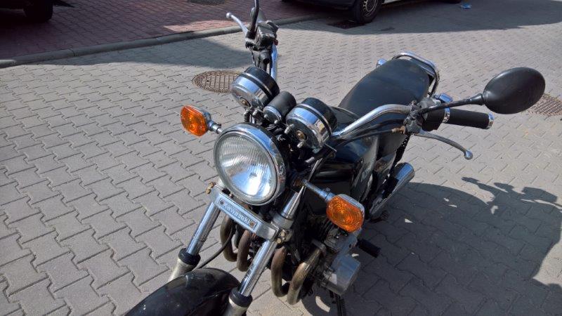

Well, hard to say. In German documents is written J, but mistakes can allway occur. What can detemine if that is A or J? Maybe VIN or something???
