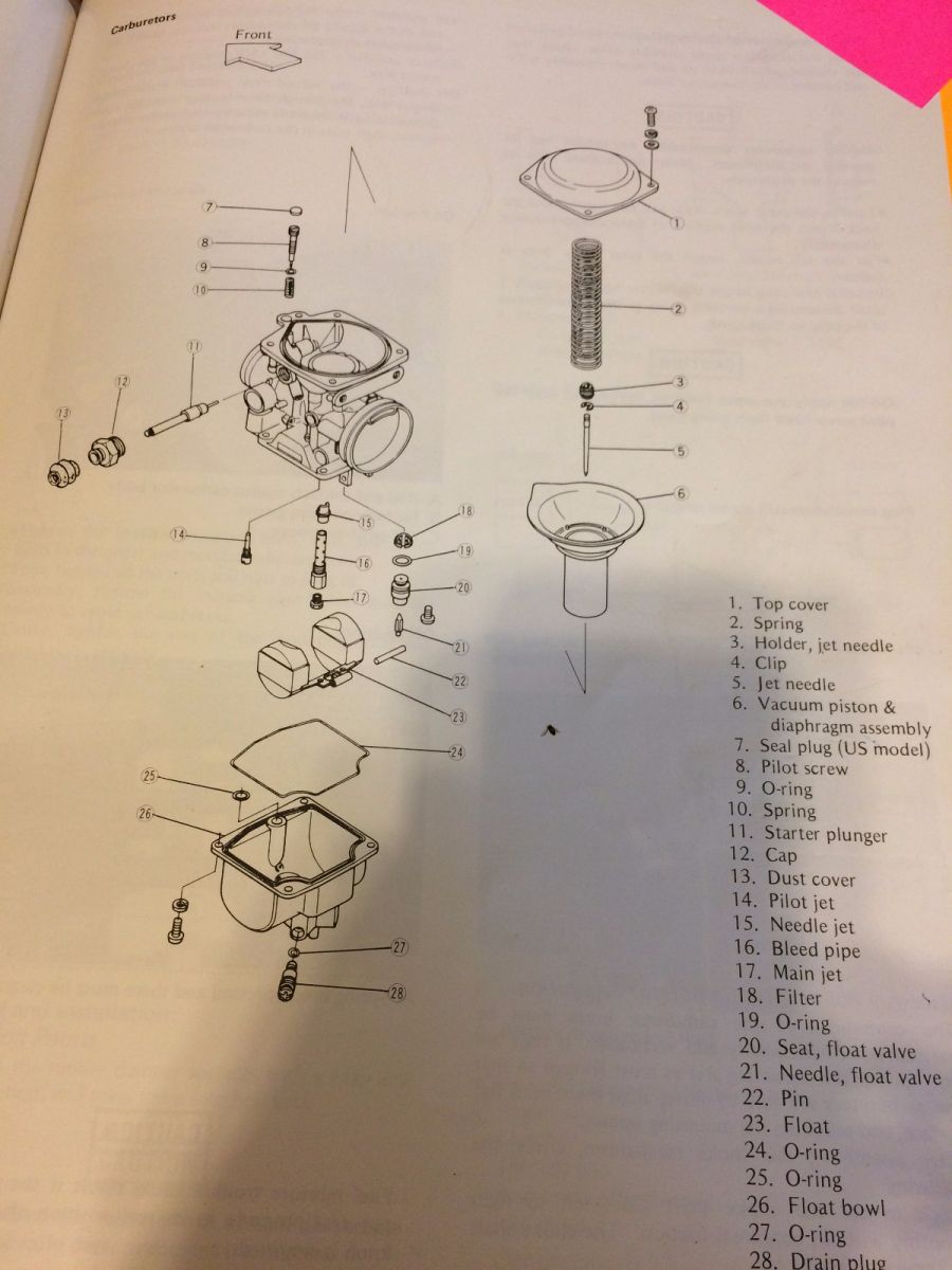

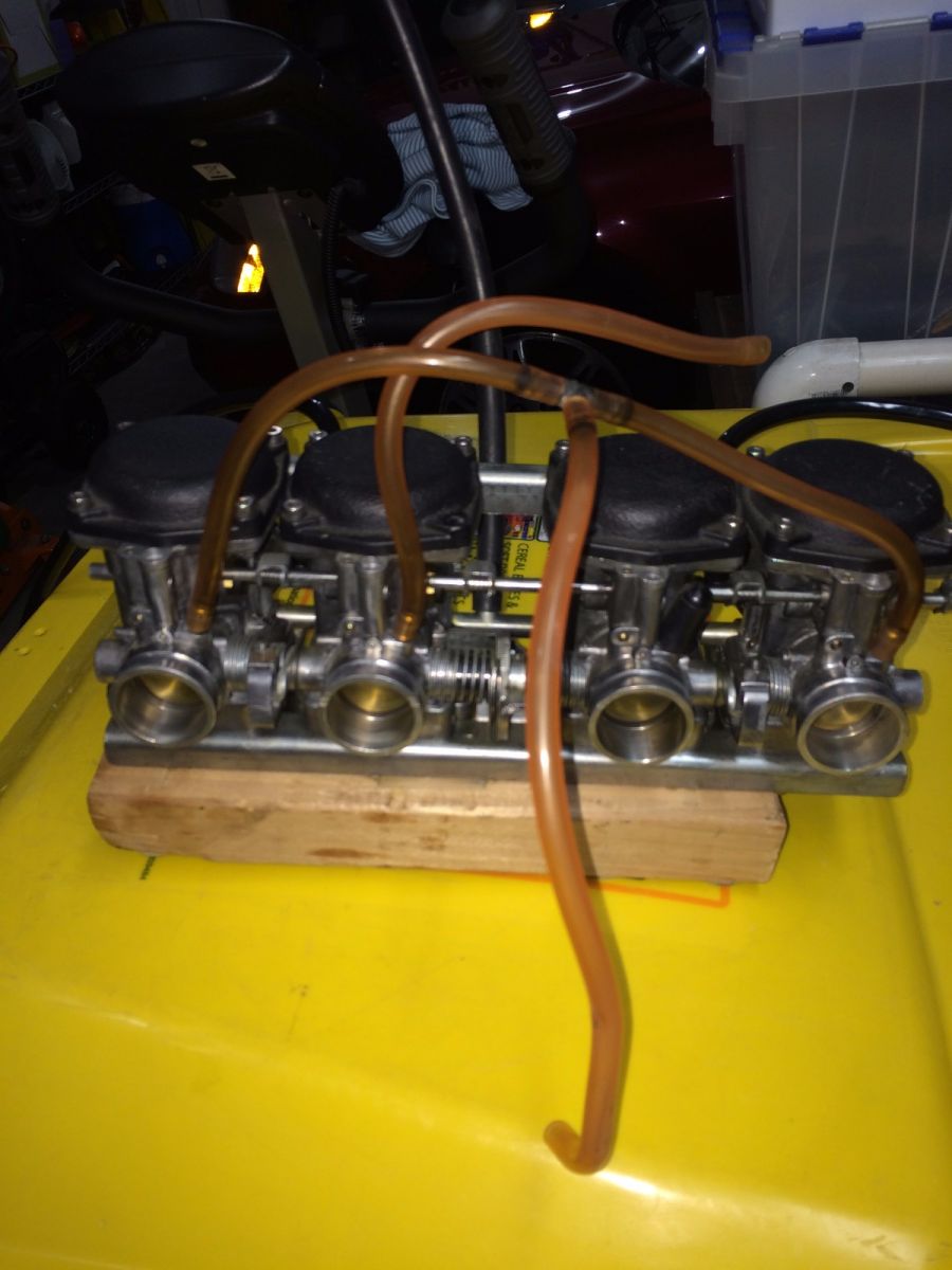

Here is a diagram from the maintenance manual for the '83 Spectre 550 Shaft drive carb page. I have dissassembled and checked/cleaned parts 1-6 and 14-28 in all four carbs. I have not touched parts 7-13 in any of the carbs. I sent the carbs down to TX to wiredgeorge about five years ago and got them back (also photo attached) without any of the the seal plugs (#7 on the carb page diagram). You can just look down the hole the see the pilot screw (#
with a flat head screw on top.

#7 is not needed as long as the oring on the pilot screw #8 is in decent condition.
The rubber/plastic plug I was referring to covers the pilot circuit, but your TK26 carbs did not come with it according to your diagram.
The "choke", called here a "starter plunger", I believe actually just eliminates vacuum from the top of the CV slide. This prevents it from lifting, or from lifting at the same rate. This causes more fuel to get pulled since the air is now being restricted. But if the plunger #11 doesn't return all the way or doesn't seal, there will be too much fuel during normal operation. I think something similar can happen if the diaphragm has a hole in it.
Other plunger-style chokes sometimes just give an alternate path for fuel to flow. These are usually called enrichener type chokes, as they don't actually choke anything. I'm not positive what type yours is.
If your #4 plug is covered with gas, then check your plunger for proper operation. But don't get too far into that without checking some of the more basic things I mentioned... spark, compression valve adjustment etc.
