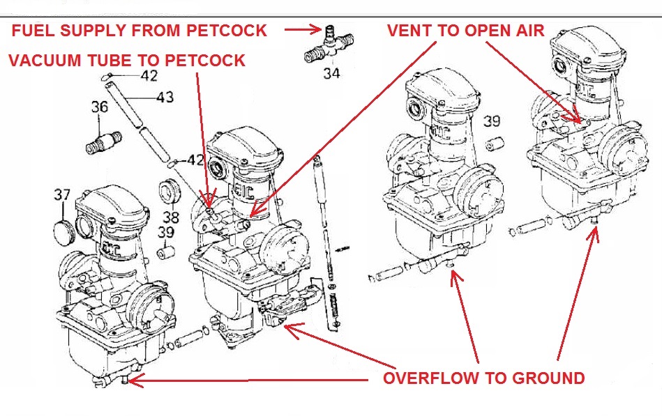

The bottom of each carb bowl has a nipple for overflow. Hoses should be attached to them and those hoses should terminate behind the engine pointing toward the ground. Carbs #2 & #4 have vent nipples on top that should have hoses terminating into the atmosphere near the air box. Carb #2 will have a nipple on top toward the engine end of the carb that connects to the stock petcock. It provides vacuum to operate the petcock when the engine is running. See image below.
