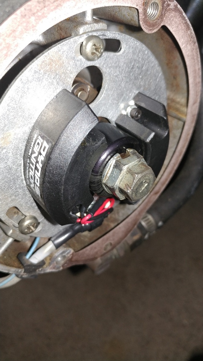

26 Apr 2017 20:50 - 26 Apr 2017 21:11Attachments:

Look through that hole in the center of the pic. You'll see the pin with an E clip on it. that is the weight pivot for your mechanical advance. Make sure that the weights move freely.
Also note that the entire pickup or pulse generator plate is set to almost full retard. Can you verify your ignition timing is correct? I am not familiar with that Dyna ignition so you'll have to research how to check ignition timing with that setup. If you timing is retarded it will seem sluggish from mid range on up.
