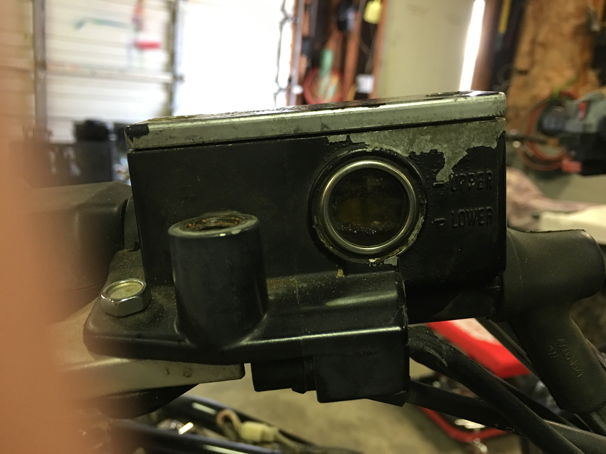

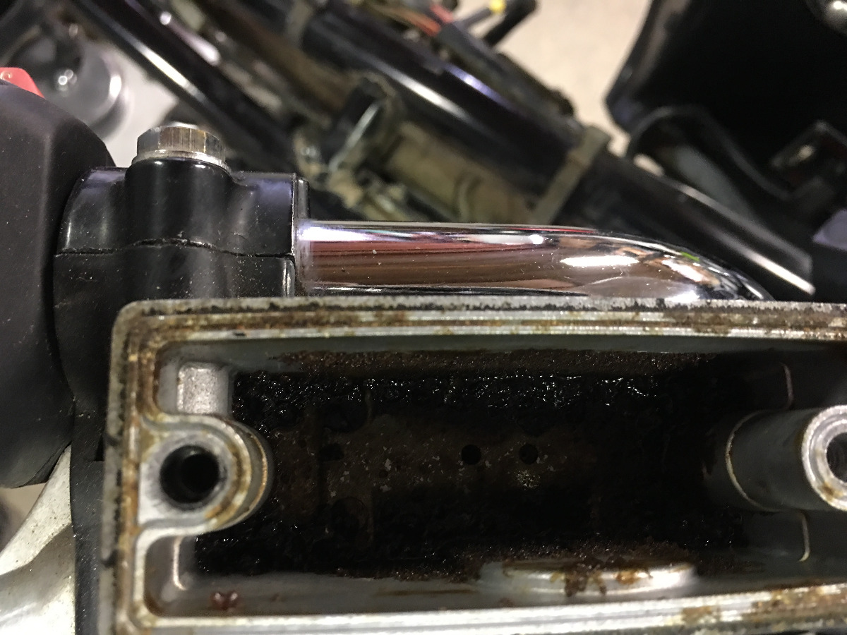

After much pounding, hammering, and chiseling I got the top of the master cylinder reservoir off. No front brakes, and when I first looked in the sight glass, was not encouraged by the fact that there was a 'level' that did not move when you moved the bars
This master cylinder may be beyond rebuilding...
