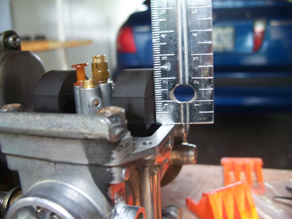

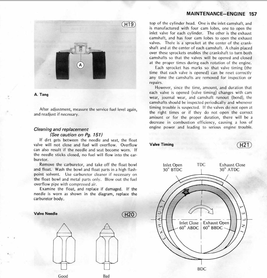

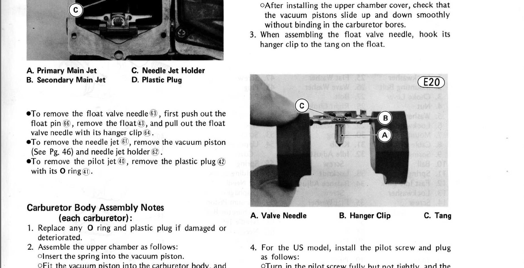

29 Mar 2017 16:27Would this happen if I installed the float upside down?
Quite possible.
Pic of float in the correct orientation
