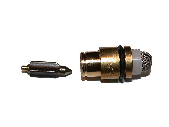

Got some leaking float valves but just about every place I look is out because they're obsolete. Does anyone know if there is an equivalent to the oem 16030-1018 float valve and seat? Like the 82 750 r1 float valve and seat?

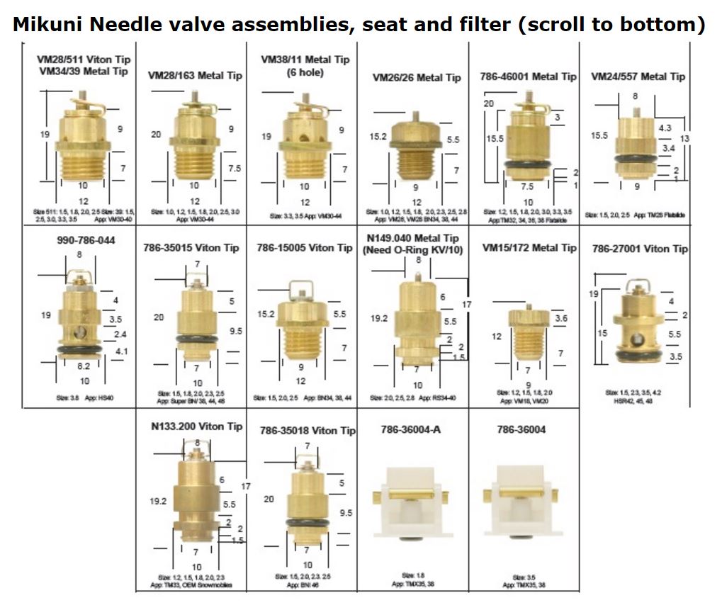

The N149.040-X.X type is typically used in Mikuni CV type carbs. The X.X references the seat size. According to the parts fishe the 650 uses a 2.3 seat size and the 750R1 uses a 2.5. Interestingly, the GS1000 Suzuki uses a 2.0. I suspect it doesn't matter that much which you use since even the 2.0 will flow plenty of fuel for the engine.
You can get these parts from Jets R Us or Amazon. www.amazon.com/s/ref=nb_sb_noss?url=sear...ld-keywords=N149.040
