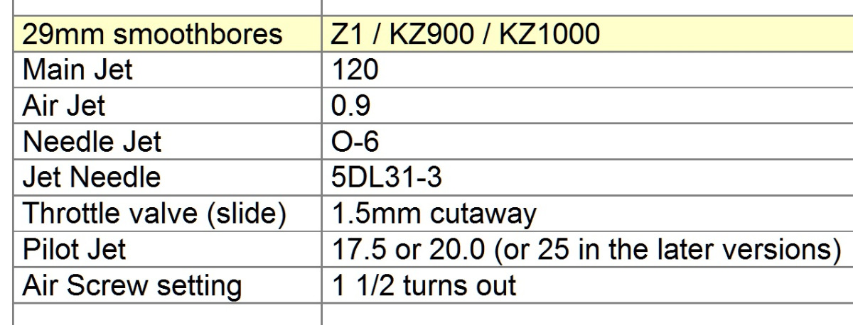

I was under the impression that a stock KZ900 running Mikuni 29mm carbs with pods and a V&H header with no baffle would need a 120 main jet and either 17.5 or 20 for the pilot jet. Correct me if I am wrong.

Sudco recommends 25s (but they also show that for KZ650 through 1000s so I don't know) but a lot of searching (over the years) has shown folks on here are running 17.5s and 20s like you say....... I can't get anything to come up on search so I don't know if the update lost em for now or what. The removal of the baffle changes things too and unless your at the strip it might run better on the street with it in.
Goggle smooth bores and KZR and you should get some things to read. Too high of a setting for the fuel level, leaky float valves and or dirty low speed air passages and air screw settings could be part of the problem too but it could be the pilots just as well.

This used to be on the Z1E site:
When in doubt, would start with 17.5, and test for best steady-stable idle, strong pull-away, and good performance throughout the 1st quarter throttle range. When properly tuned, the smoothies should be almost as user friendly as 26mm manual slide Mikunis (at least when using the stock airbox).
gd4now wrote: It is my understanding that there were at least 3 versions of the vm29s offered. the A2, A7 and A12. There should be an ID stamped on the flange either below the choke lever, or on the other side of the carbs something like the following
29
A2 - this second line could be any of the other types noted above
IIRC the throttle valves have a larger cutaway on the A12 than the other 2 do. The A2 has a smaller pilot jet (17.5) than the others and a smaller needle jet than the others.

On my kz900 I got 120 mains and 25 pilots with a kerker 4-1 and Z1 air box.
I first use 17.5 and the 20 and back fire from 3500 to 6k then it would clear up.
Air screw at 1/4 turn out...any more then that if I blip the throttle it boggs
1200-1500 rpm idle
