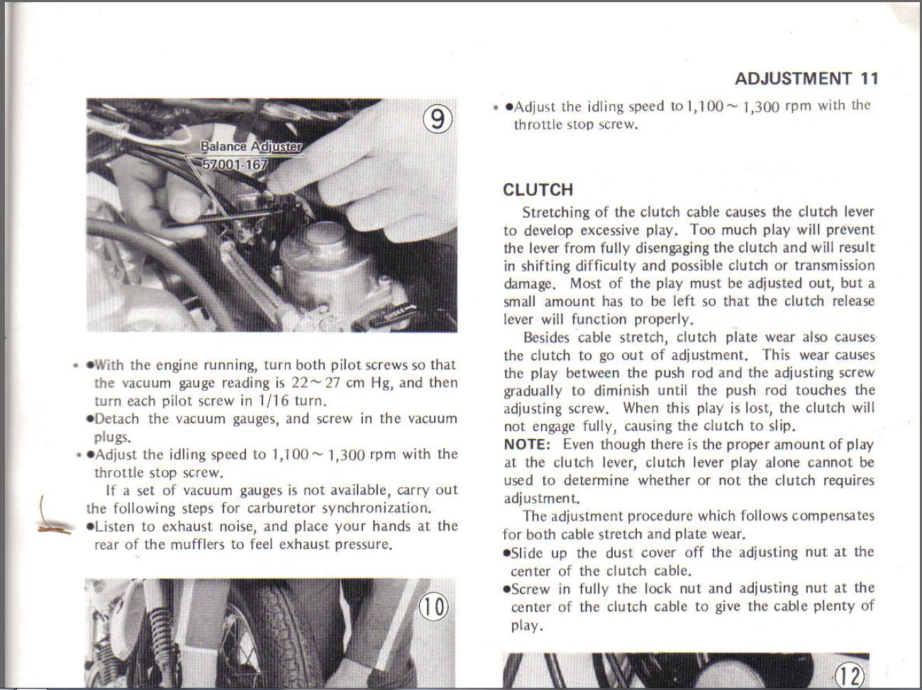

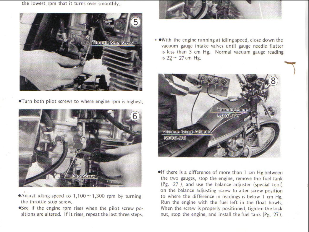

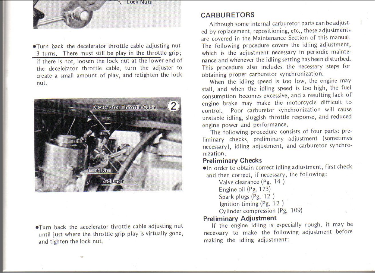

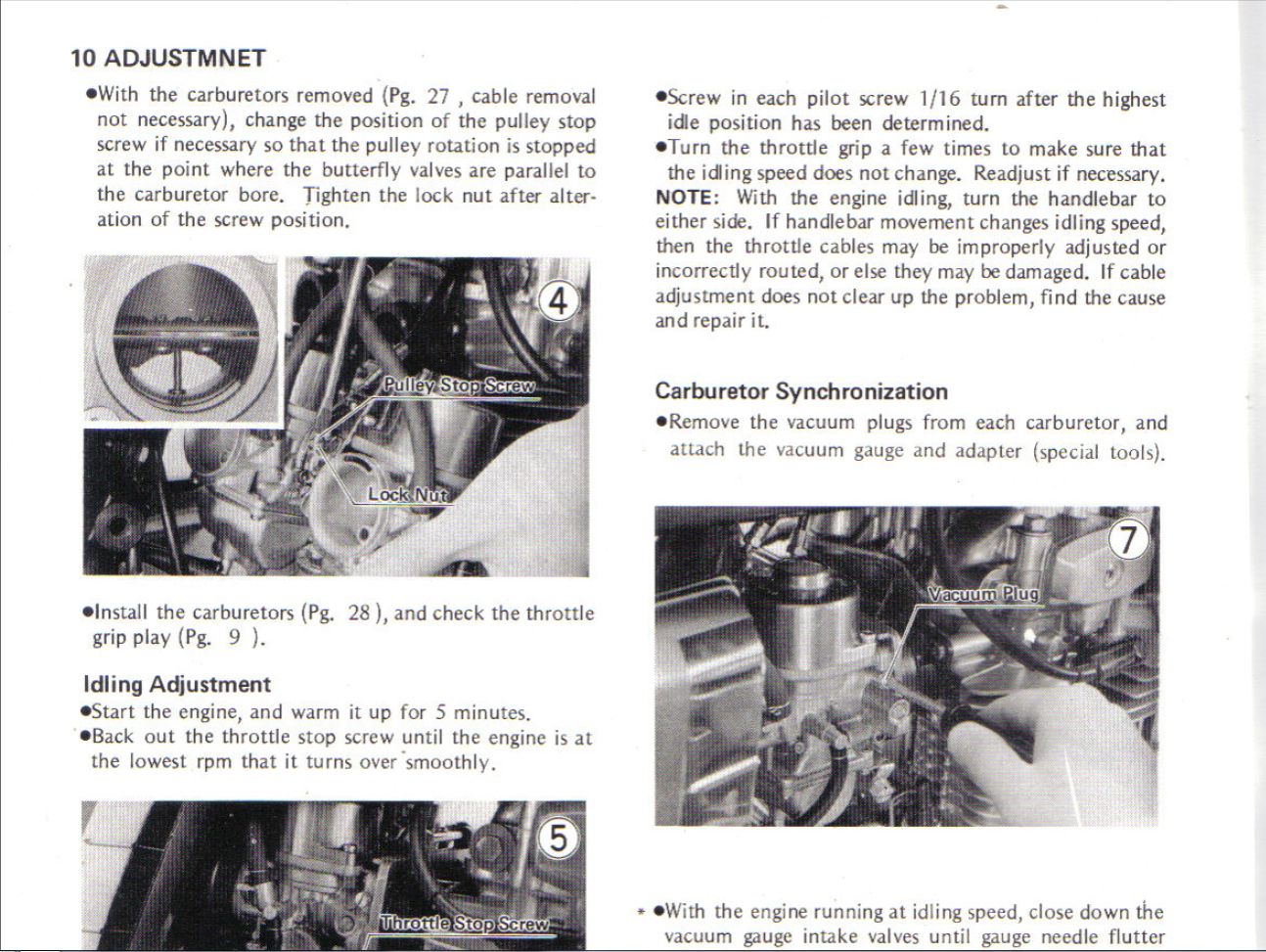

What do you mean with when you say "my new mikunis VM30's"? Have you rebuild them by your self?
Are the carburetors synchronized?
Intake boots with no air leaks?
Float bowl high correct?
Air screws set to reference?
Air filter and housing stock or K&N?
Ignition timing ok, correct gap on pointer(dwell)?
Get the full services and repair manual
www.manualedereparatie.info/manuale/Kawa...dereparatie.info.zip

Re: Finally got my KZ400 to start! But........
09 Mar 2017 17:06
Spray brake cleaner on the intake boots. If the engine revs different as usual (mostly lower) you have an air leak there.
Pic“s are out of th service manual in my first posting. Get it.

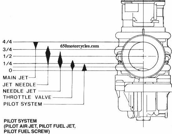

After you get the pilots set you can work on the mains and lastly the needles. You can do this by marking 0, 1/4, 1/2. 3/4, and full throttle with tape on your throttle and doing throttle chops at each setting. Adjust the proper jet system based on the photo showing systems vs throttle position.
