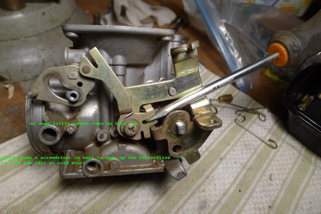

Some photos showing the linkage with choke on and off. I think you need to bend the linkage as shown with the screwdriver if you want to increase the idle with the choke on.

That's exactly what I needed. I presumed that there was an adjustment up the top (like a screw or something) that would bring it further away from the choke cam.
By the looks of things I think I'll need to take the carbs off for this. Even if I can access that slot with a screwdriver, it would need a fair amount of pressure, and I'd be worried about breaking something doing it at arms length.
I guess my other option in the mean time is to add a spacer. I might try making a small aluminium clip to sit on the pulley and reduce the clearance between the pulley and the fast idle link. I'll have a look when I get home to see if that's realistic.

No screw adjustment in the system. Only way to adjust is to bend the tab as shown. The bracket bends pretty easily. I think if you remove the tank you will have a reasonable chance of reaching it.
Before bending double check my bending location suggestion.
