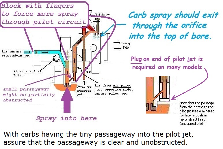

Couple of possibilities come to mind.
Imperfect pilot circuit (needs cleaning);
Too tight valve clearance.
Symptoms of marginally too tight valve clearance are usually worse at lower rpms.

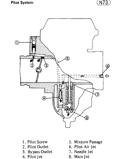

Just to add to Pattons post
When I bought my 1980 750/4 several years ago I had a persistant stumble at about 2500 - 3000rpm. To make a long story short it turned out to be dirt at the pilot bypass. See #3 in the attached schematic. If you think this might be your problem then look for 3 tiny holes at the indicated location just behind the throttle butterlfy and poke them out with a fine needle or bent @ 90 degree guitar string and do the spray procedure which Patton describes above.
Wear eye protection
Good luck
Wear eye protection
Good luck
