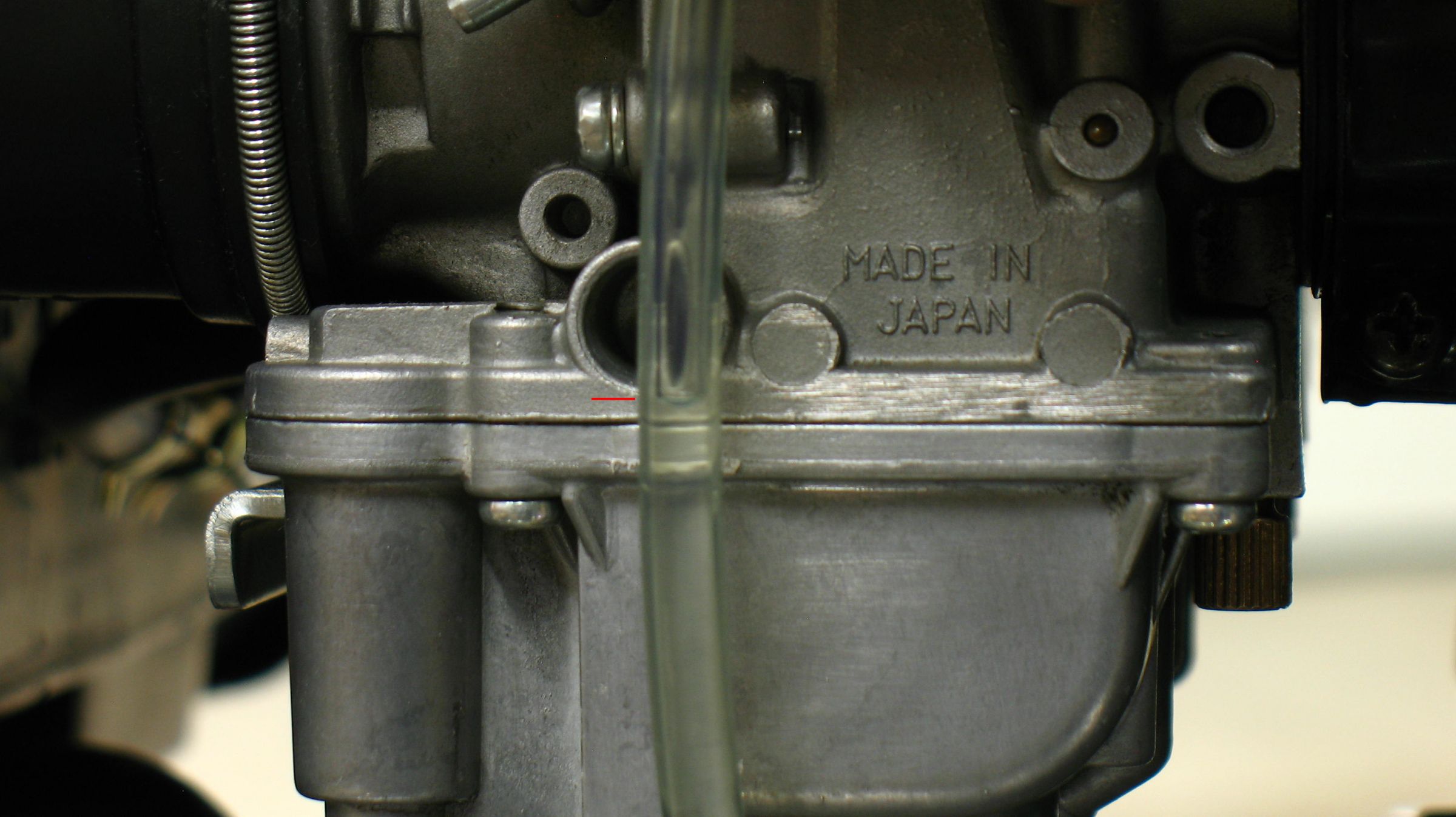

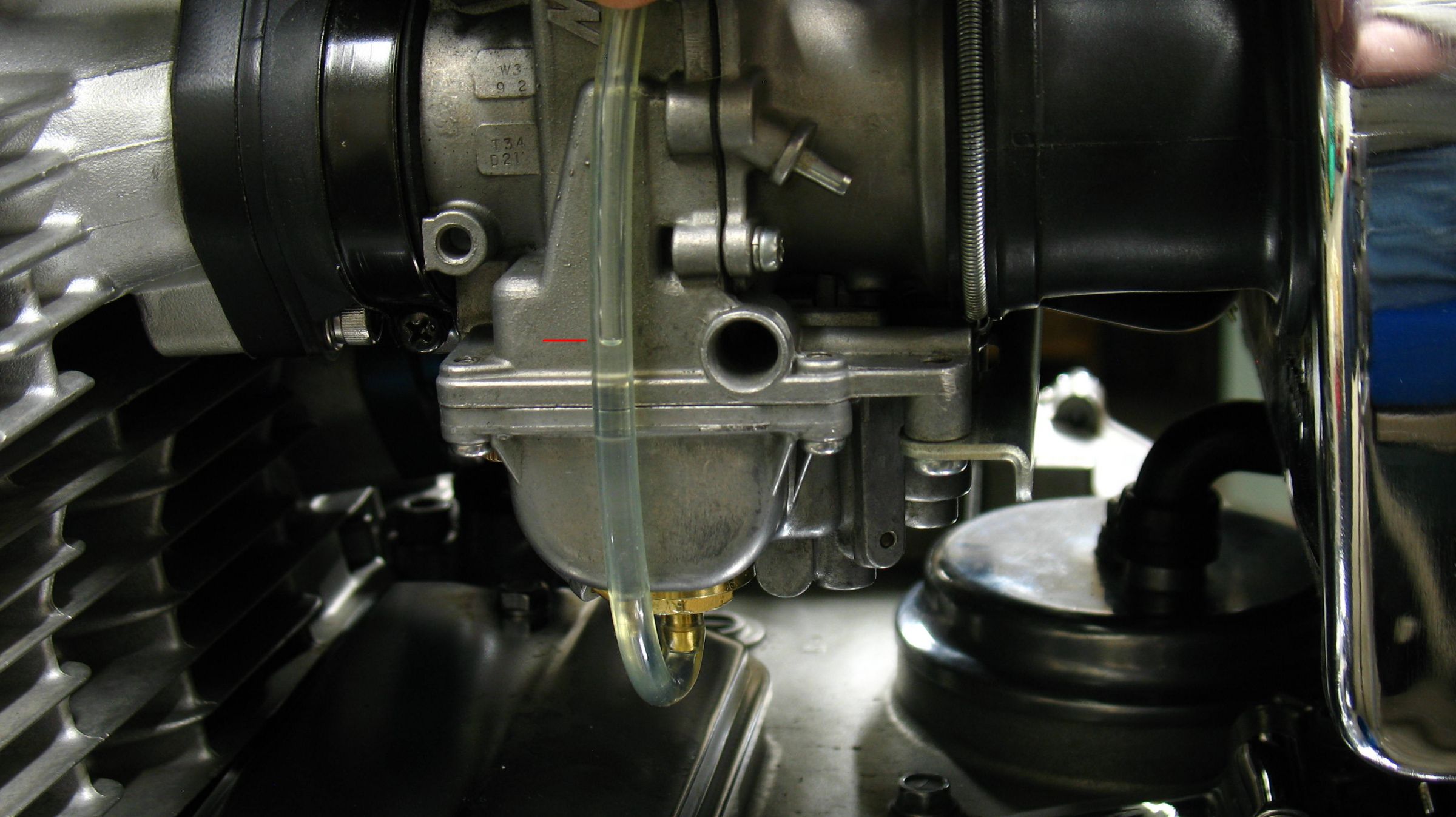

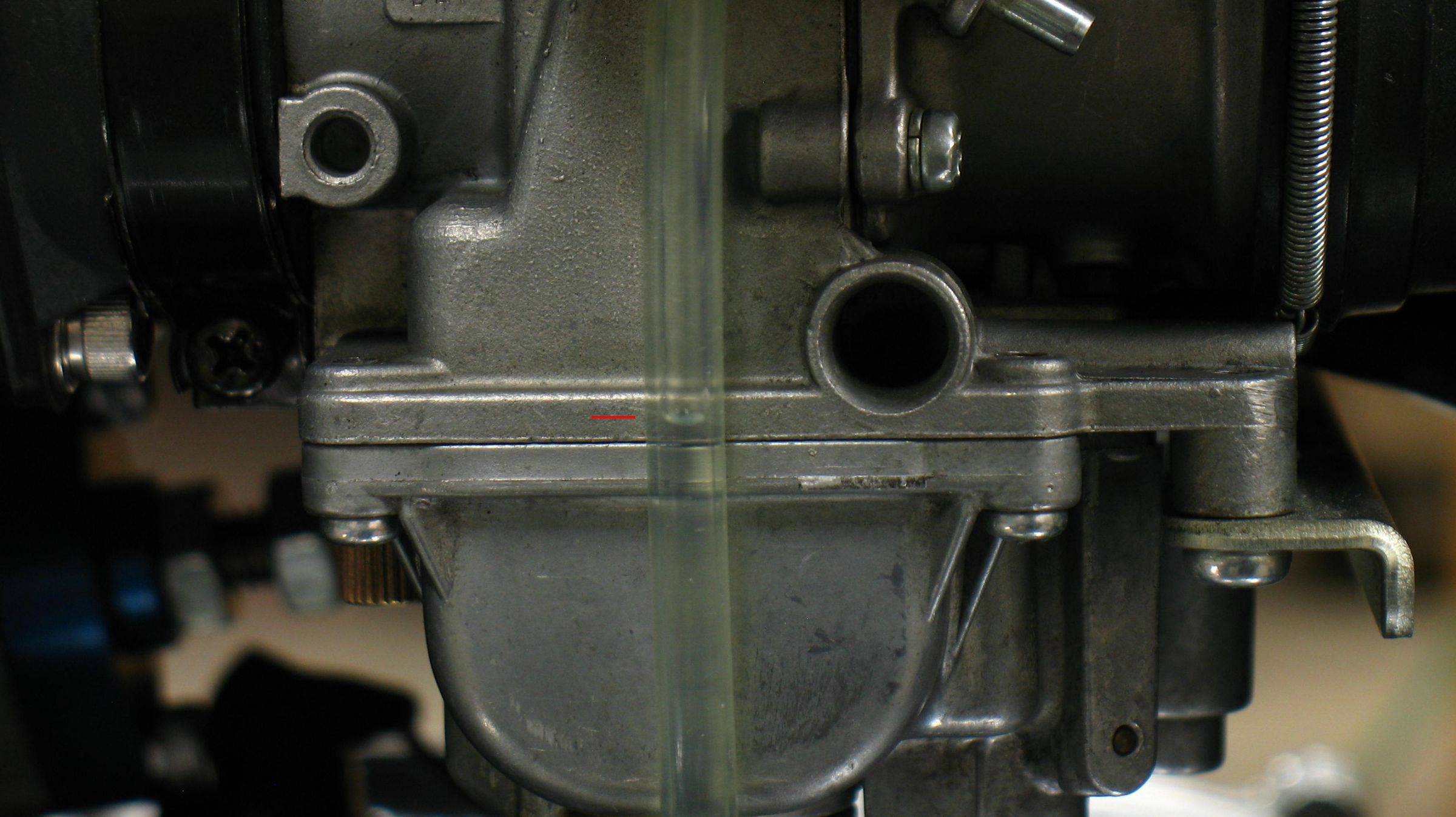

16 Jan 2017 15:37 - 16 Jan 2017 16:10Nessism wrote: Does Mikuni spec out the fuel level in the carbs so the clear tube method can be used to measure fuel level? You would have to make a tool but that shouldn't be difficult.
Got the clear tube tool from Z1 Enterprises last year. It works like a champ, but there is no clear tube level spec for RS series carbs that I know of.:blink: Levels shown w/floats set at 19 mm, not 17 mm per spec.:
Right side, on center-stand
Left side, on center-stand
Left side, on side-stand

your photos show that the fuel level is too high. The fuel should be a few mm below the top of the float bowl. I'd bend the float tangs some and get the level lower.

16 Jan 2017 19:35Nessism wrote: daveo,
Perhaps this perceived discrepancy is why there is no spec for the clear tube method on Mikuni RS series carbs.
The levels shown in the photos have the floats already set 1 mm. out of spec at 19 mm. rather than 17 mm. +/- 1 mm. The floats would likely need to be set at 22 mm.+ for the fuel level to drop that much, at which point there may not be room in the bowls for them function correctly. Mikuni does not suggest such alternative settings for the floats.
Last year when I ran the clear tube test on my sold set of RS36's, the results were exactly the same, so I think the RS series carbs were uniquely designed to have fuel levels higher than other types of carbs. :S

IMO, the fuel levels are too high, and should be below top of float bowl.
Measured float height is correct ONLY when it produces the correct fuel level.
A true overflow tube located inside a float bowl would usually be expected to have it's top opening slightly above the designed service fuel level and below the top of the float bowl (i.e., below the float bowl gasket).
I don't know if it's possible to install the float upside down on these particular carbs.

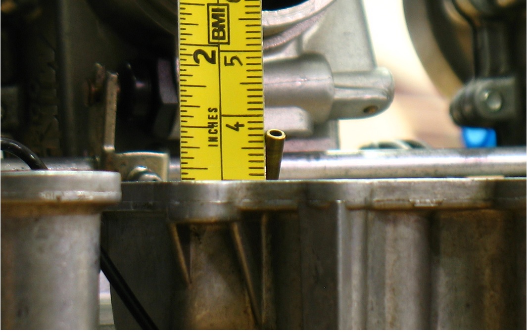

One side question (probably stupid, I know) --- Is it positively certain that the tube shown below is an overflow tube and NOT a vent tube? :huh:
The reason for asking is that the Mikuni description includes the following:
• Float Bowl Vent: Allows atmospheric pressure into float bowl for fuel flow.
And I haven’t been able to find anything from Mukini that mentions an overflow tube or an overflow circuit in the RS series.
As gaskets sooner or later deteriorate, a service fuel level above the gasket is an open invitation to leakage past the gasket.
If Mikuni designed the RS Series this way -- again, Boo on Mikuni.
On the other hand, perhaps Mikuni deems frequent or routine gasket renewal to be acceptable with high performance racing carbs such as these.
BTW, does the top of the pictured tube exit into the carb bore? Hopefully not, especially if it's an overflow tube, as an overflow circuit should prevent raw gasoline from ever entering the carb bore in the first place.

The size of the opening suggests a vent tube. Overflows typically have a small hole.
