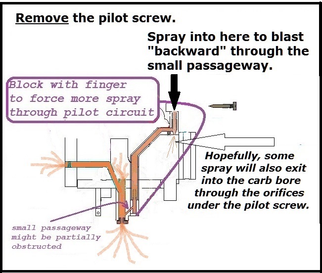

If combustion occurs when using starter fluid but not otherwise, fuel might not be entering the carb bore due to an imperfect pilot circuit.
Here are some techniques to help assure fuel mix is getting from the pilot circuit into the carb bore:
