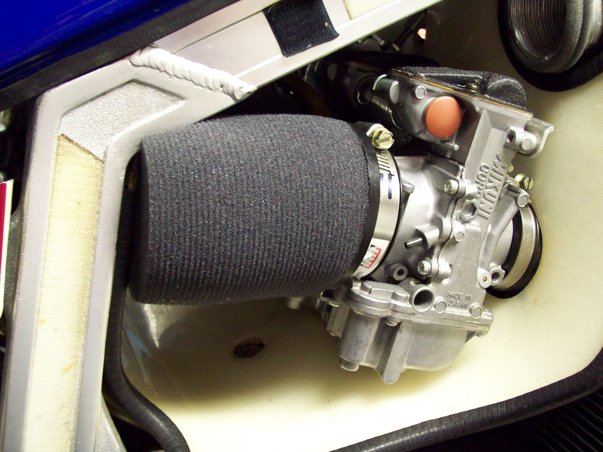

I have real good luck with Unifilters in the past.
In my opinion, the Uni's flow almost as much as open velocity stacks.
I am only one main jet size smaller on my RS36's with Uni's than the RS36's with open stacks!!!

Re: question about foam pod filters...
10 Jan 2017 14:28I like that vented heat shield Gamma...
10 Jan 2017 23:49Thats a good looking set up Kawa, how well does it work, incorporating stacks is the trick...

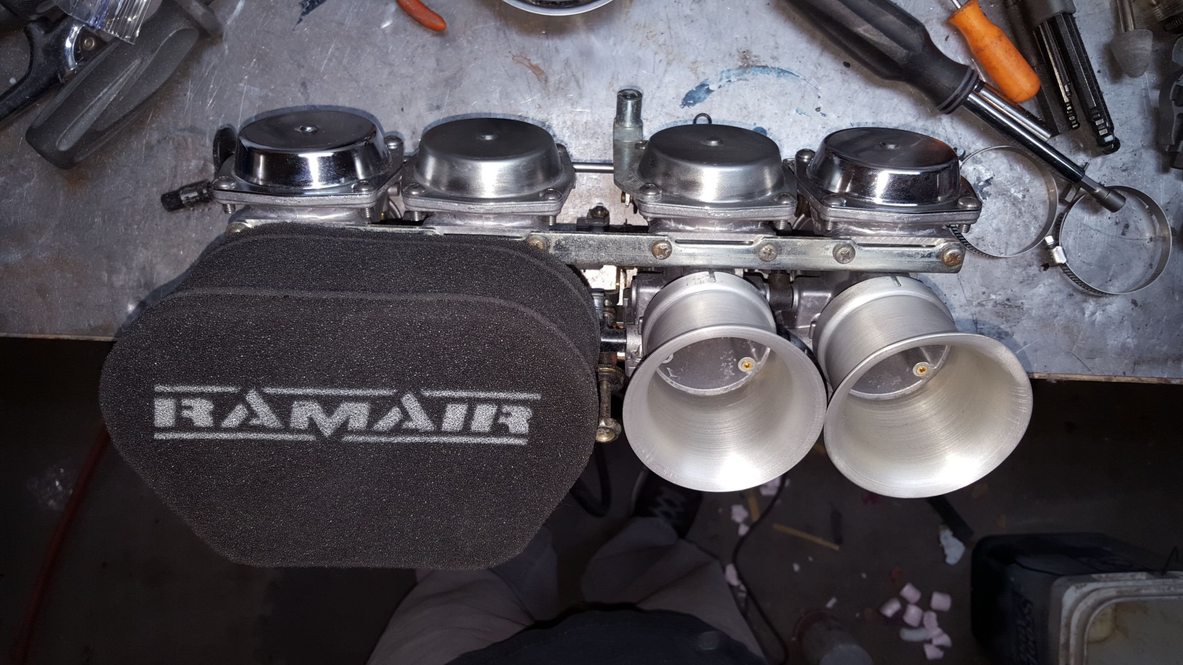

11 Jan 2017 07:31 - 11 Jan 2017 07:33
Ordered one RAMAIR set before Christmas, and three weeks of dreary-winter will have passed by the time it gets to my door.
So why did I put the air box back on my bike. :silly:
