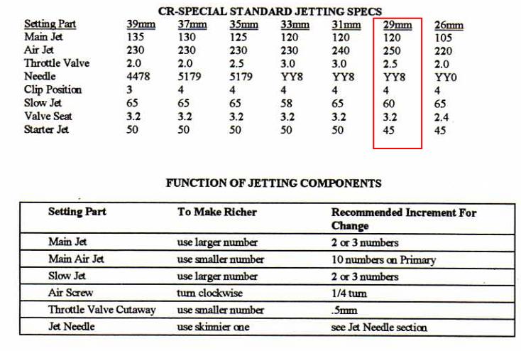

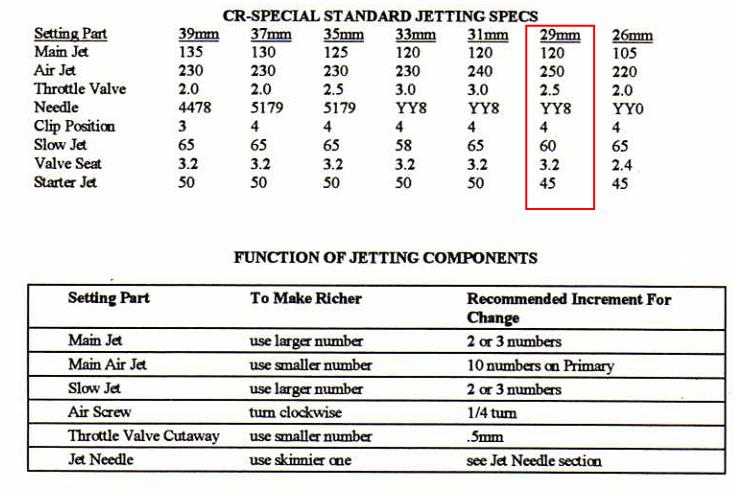

Thanks for your input stone. I'm hoping someone with a more similar set up chimes in. I'd like to get a baseline jet size in mind so when I pull them off the bike I can have them ready to install depending on what's already in there.

It makes me feel a little better to hear that a lot of people like these carbs with a few tweaks from factory. So, my next step is to pull them to see what size jets are in them. I'll buy a few different sizes that were recommended in that thread then check the float levels (after I build a carb holder from another thread I just read! Which is awesome!), then I'll reinstall them and sync them up after I buy a synchronizer.
Much appreciated guys! Thank you!

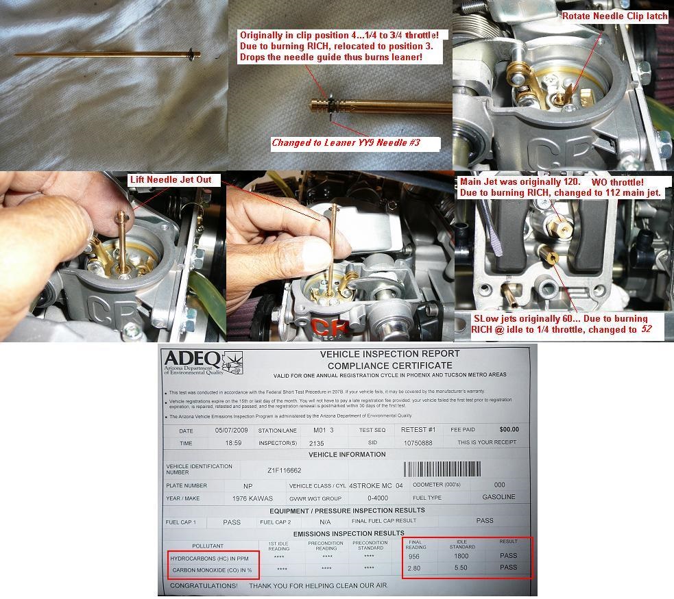

Once you get them dialed in, you'll witness the difference....
As mentioned, they come from factory RICH....
Phoenix AZ @ 1200 elevation, weather 3/4 of year 90 to 115F (Yeah I know, feakin hot)
Mains @ 112
Pilot @ 55, could go down to 52 but being so hot here, rather it'd be a tad on the rich side then lean.
Needle, YY8 clip position 4..... I change clip position between cold and extreme hot 90F plus temps...
Mains @ 112

So, I got to pull the carbs and dig into 1 of them. Didn't take it fully apart, but I got to see I'm running 120 mains and the needle position at 4. Don't know which slow jets yet.
OMR, with your 112 main and 55 pilot, are you happy with the results? Is it jumpy at low speeds like I was describing? Where's a good place to buy a variety of main and pilot jets?

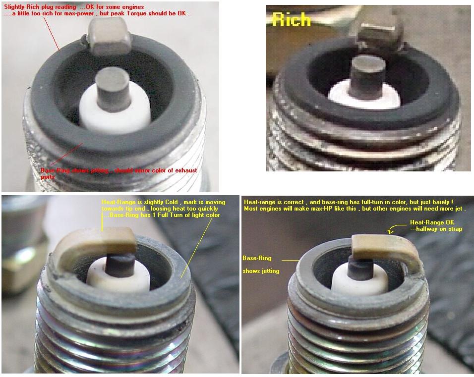

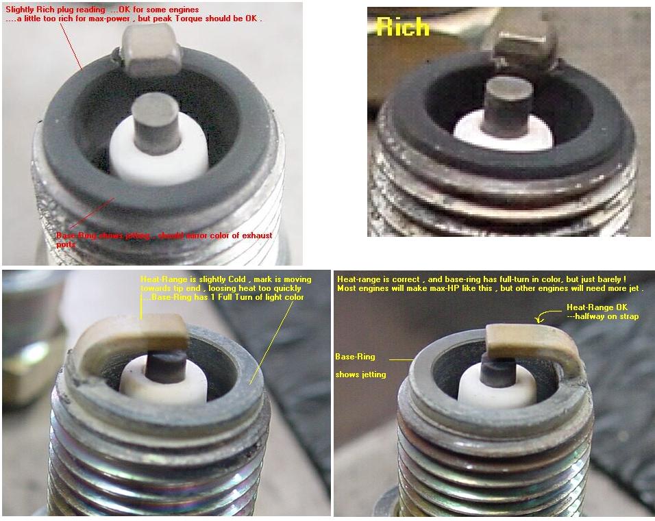

Yep.... She'll run a tad on the rich side (plugs slightly sooted) and she'll purr to life easily, nice idle 900-1000 rpm.

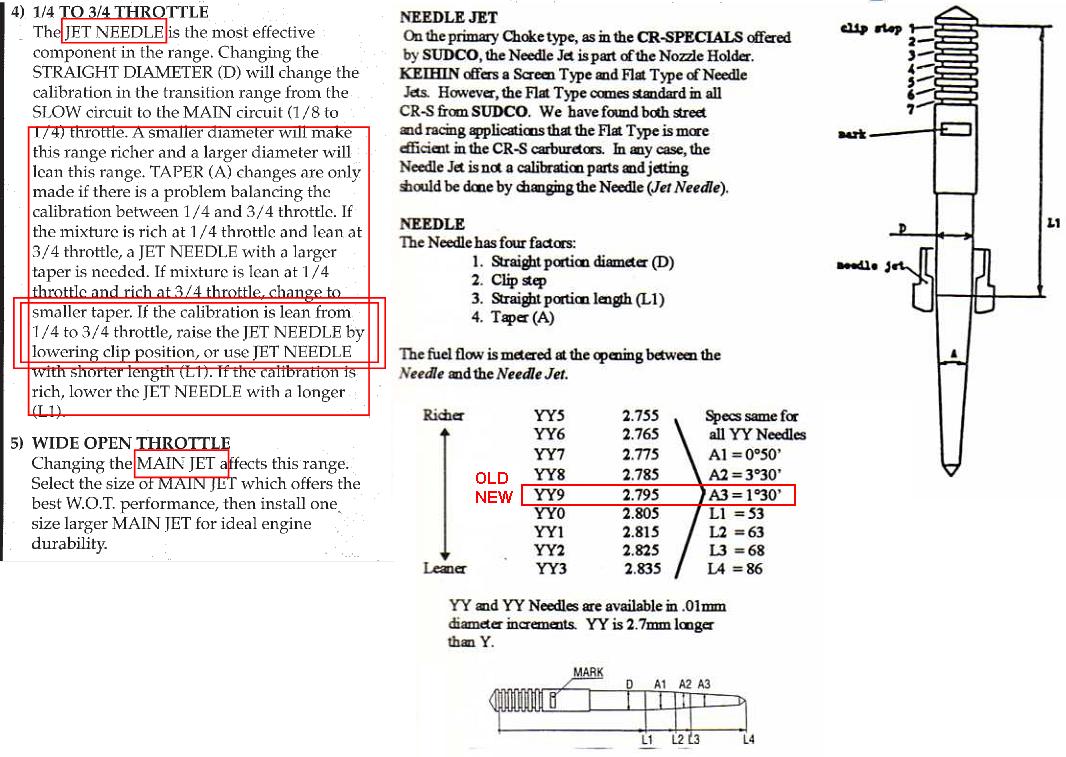

With 52 pilots & YY9 needle w/ clip position 3, found pending time of year and heat index spark plugs are more gray in color than suit brown/black but found she'd jump around in idle where I'd raise the idle to ~ 1200-1300 to compensate.
You'll also find where these carbs don't need choke.... Pending your environmental conditions, raise choke ever so slightly and I mean slightly ~1/8th to 1/4" max is all that is required.
"112 main and 55 pilot, are you happy with the results?"

So I'm currently running a 65 slow jet and a 120 Main.
I want my set up to be the most ideal street riding setup. I want to be slightly rich as well, so I think I'll be mimicking your setup OMR. Might go ahead and order a few other jets to play with too. Leave the needle position alone, correct??
