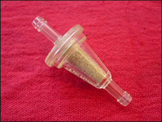

Make sure fuel filter is meant for a motorcycle. Filters designed for automobkle use often only work when used with a fuel pump. I'd use one designed for a ride on lawn mower in preference to an automobole fuel filter

02 Sep 2016 14:16This relatively common inexpensive style in-line fuel filter is popular, works well, and is readily available at many sources, including motorcycle and lawn mower dealers and repair shops, online such as ebay, automotive parts stores, etc.
www.z1enterprises.com/product/TU15-1912-1
Other more substantial in-line filters are also available.

I'm about to go to Ace Hardware and pick up a filter, as well as fill my air tank to blow some air through my passages. If this doesn't do it, I'll be surprised.
