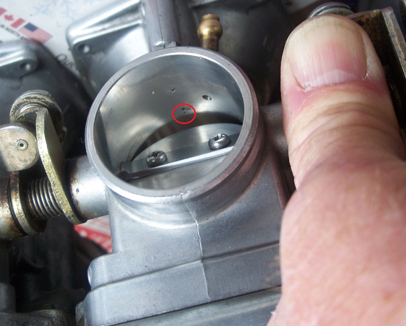

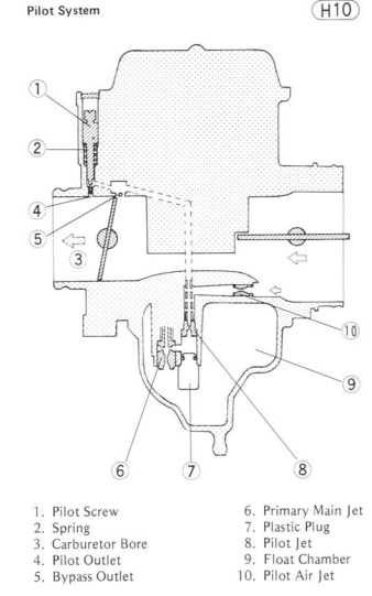

Does the "kicking and bucking" happen at any particular rpm range ? If only at the lower end of the rpm range then it may mean some dirt in the pilot circuit. About 10 years ago I had a similar problem which varied from small hiccups at 2500 to 3000 rpm to intermittent kicking and bucking at idle to the point of cut out. It took several attempts at cleaning before I found crud at 5 in the diagram below. I used a fine pin with the tip bent at 90 degrees to poke out the 3 holes at this point. You could try spraying carb cleaner in 8 and make sureit exits at 5. Wear yey protection. Carb cleaner in the eye is nasty.
I have a 750/4 and you have 440 but the carbs are very similar and the pilot assages are often overlooked when cleaning
You can see those holes by opening the throttle butterfly and looking up. pilot holes are circled in red in the photo below
