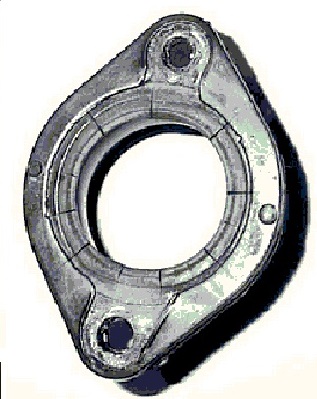

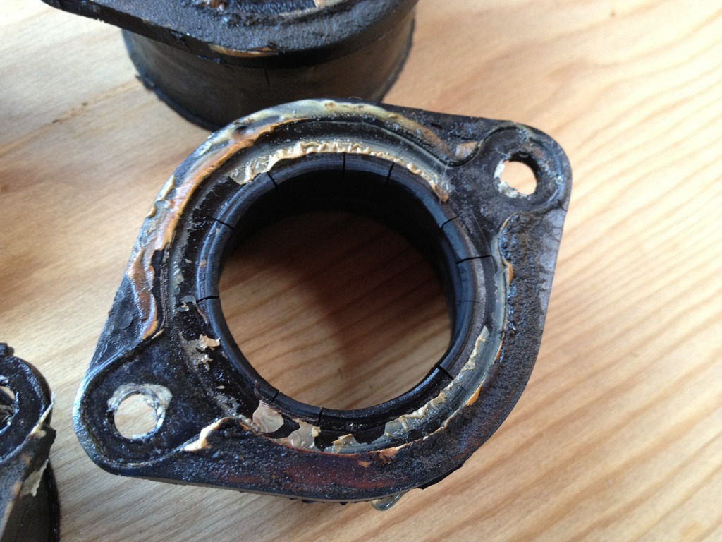

26 Aug 2016 05:08 - 26 Aug 2016 05:14Old cracked worn-out leaking carb holders can cause a "racing" idle.
Which results from ingestion of outside air into the fuel mixture being supplied from the carb.
Carb holders such as the following should be replaced.
Last edit: 26 Aug 2016 05:14 by Patton.
