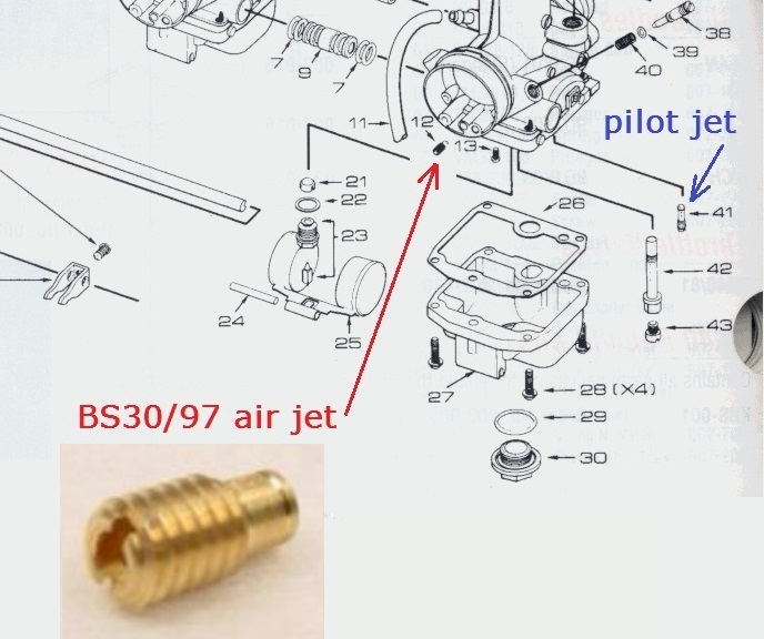

I'd compare the emulsion tubes and air jets. They may have been modified or replaced with the wrong ones. Who knows what a PO did before you got them. Used pumpers will have to be rebuilt, rubber parts etc.
