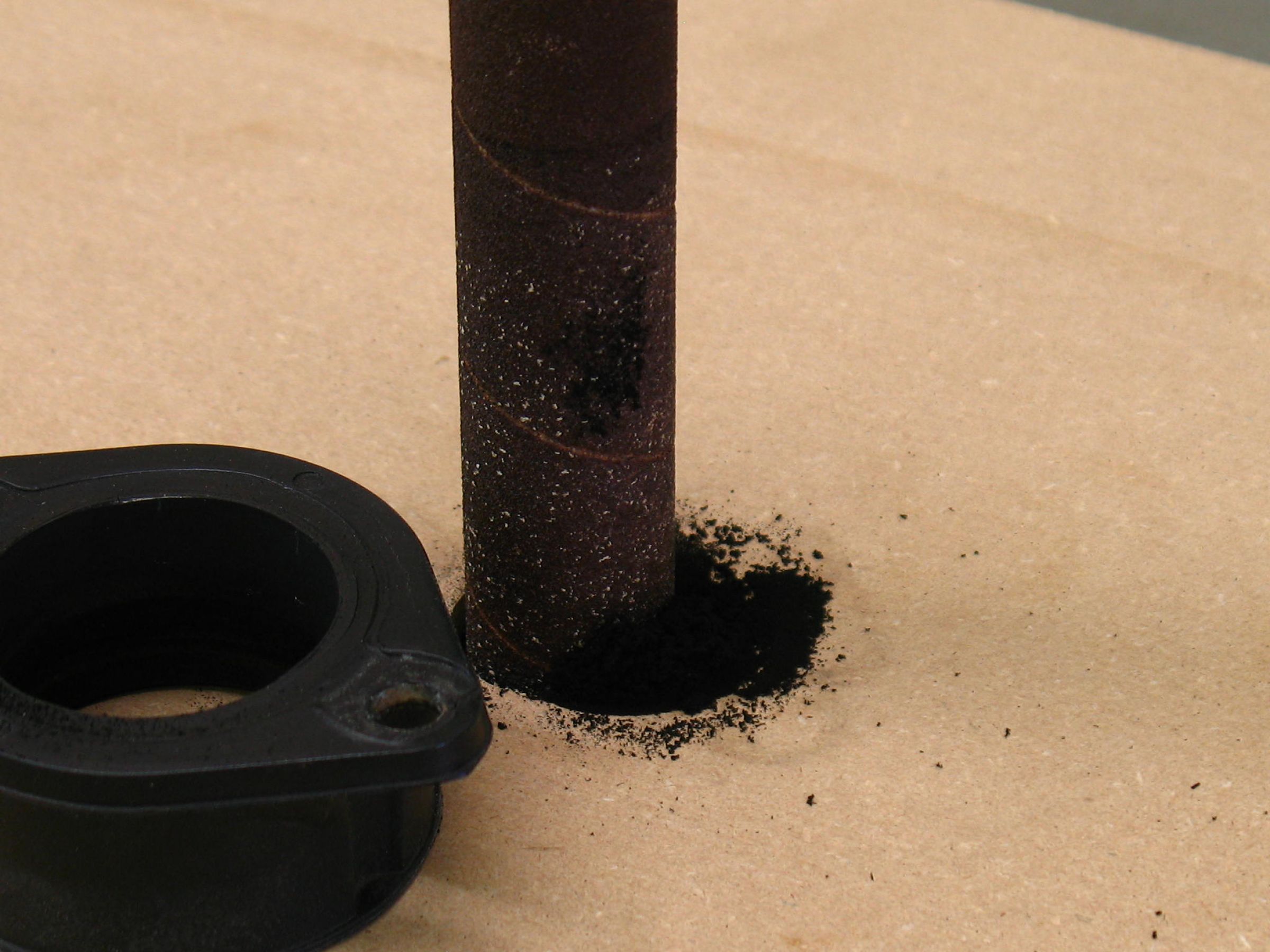

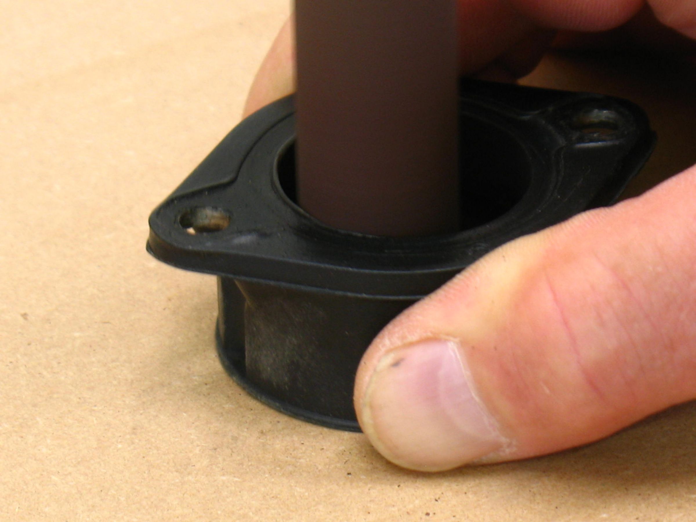

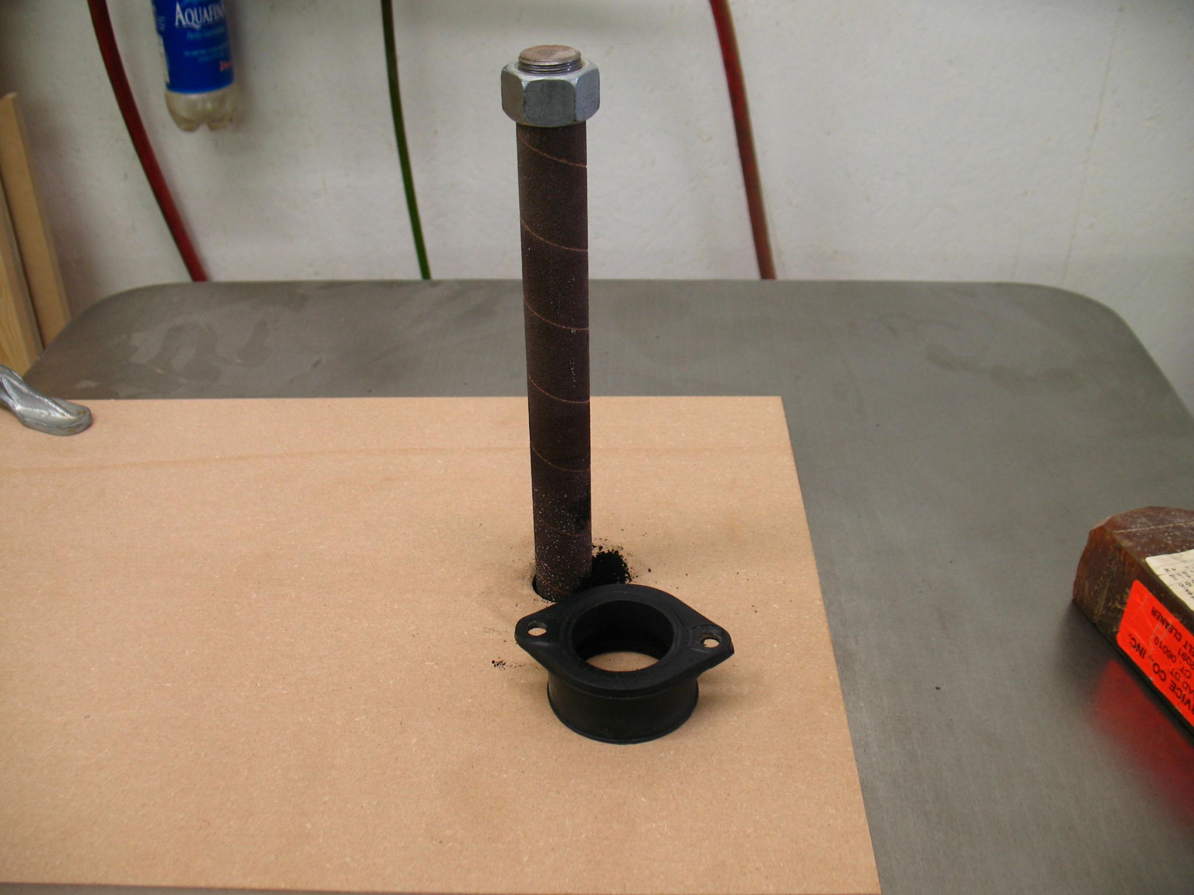

The oscillating spindle sander method...
With the removed carb manifold upside down on the flat table surface, its easy to sand off the rubber right up to the visible impression created by the edge that the intake runner formed in the rubber surface. A must to reattach the manifold in the same carb location it was removed from, for a good re-seal. The resulting inside rubber surface is smooth and flat!

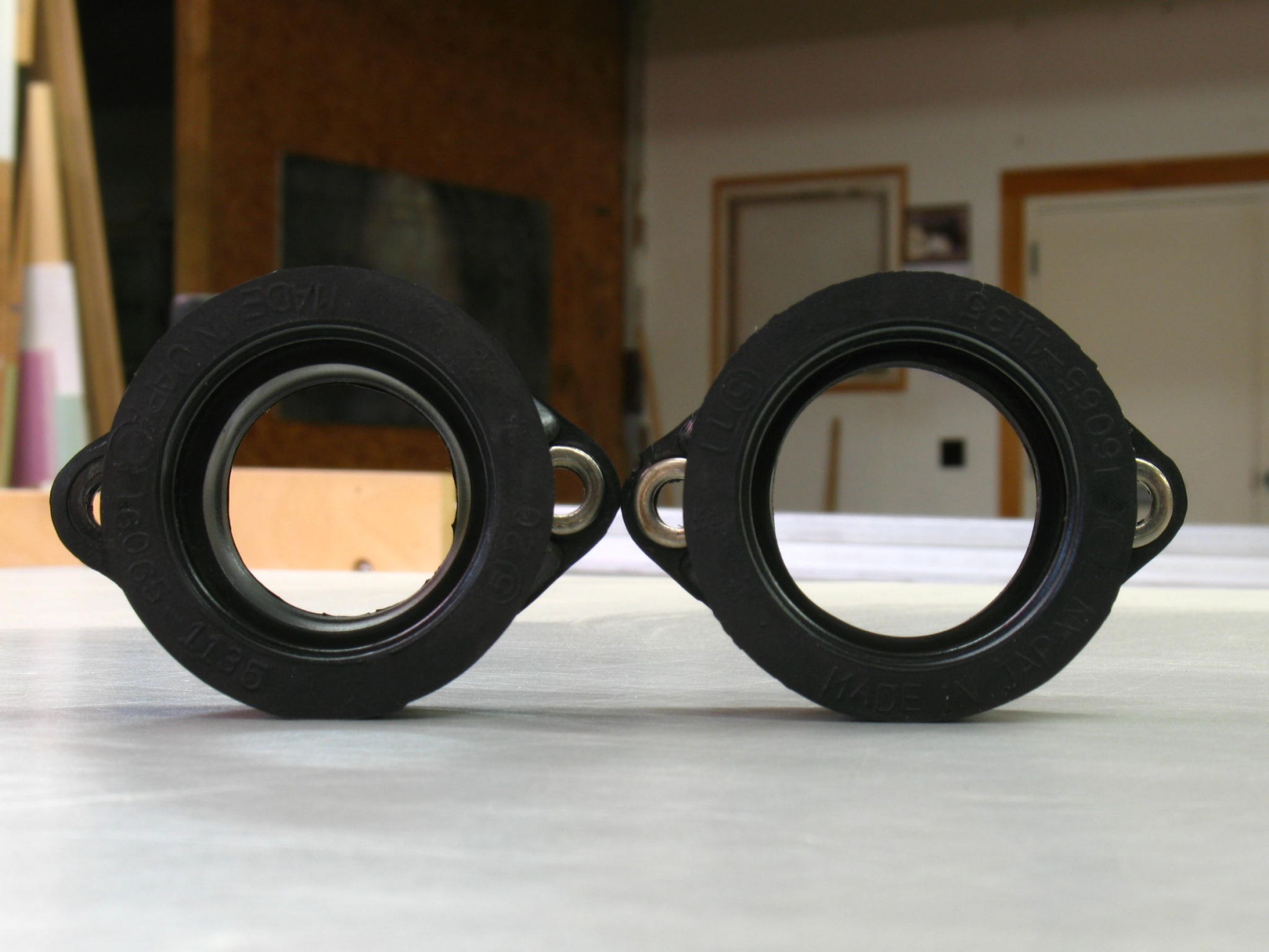

A notable difference, and worth the effort to correct :)
As before and after

daveo wrote: A notable difference, and worth the effort to correct :)
As before and after
Perhaps...perhaps not. :blink:
