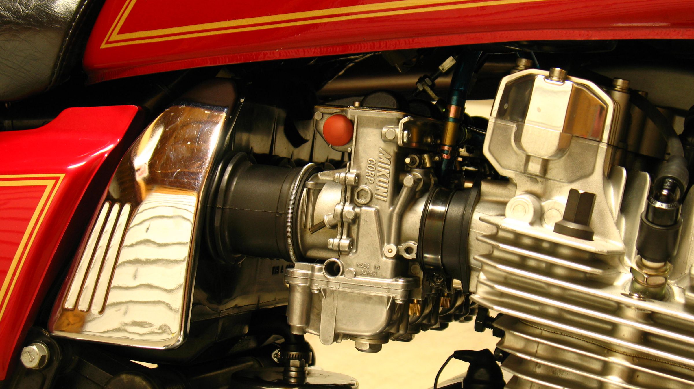

Yes sir, the air box proves this is not a race bike. :lol:
...and those rubber boots are not disguised velocity stacks, either.

Looks like they're outside the air box. Too short?

11 May 2016 08:31swest wrote: Looks like they're outside the air box. Too short?
The boots were moved out/forward to fit, because the RS carbs are 3/8"shorter (front to back) than the BS34 carbs the boots were designed for. The very-end portion of each boot fits snugly inside the air box holes, while providing the necessary seal.

Would the longer carb holders have made it fit?
