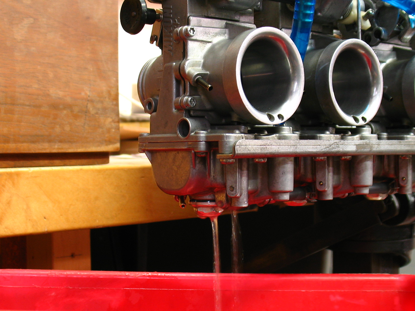

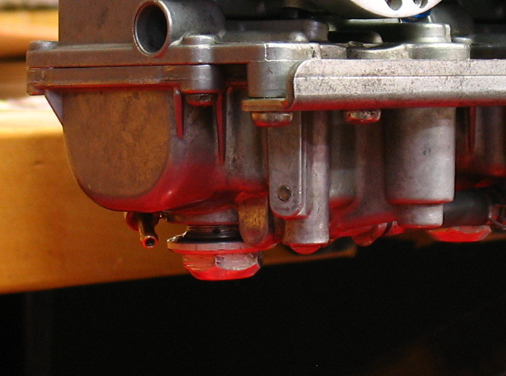

kaw-a-holic wrote: Where did you get that cap for the clear tube method?
Z1 Enterprises...less-pricey combined with another purchase.

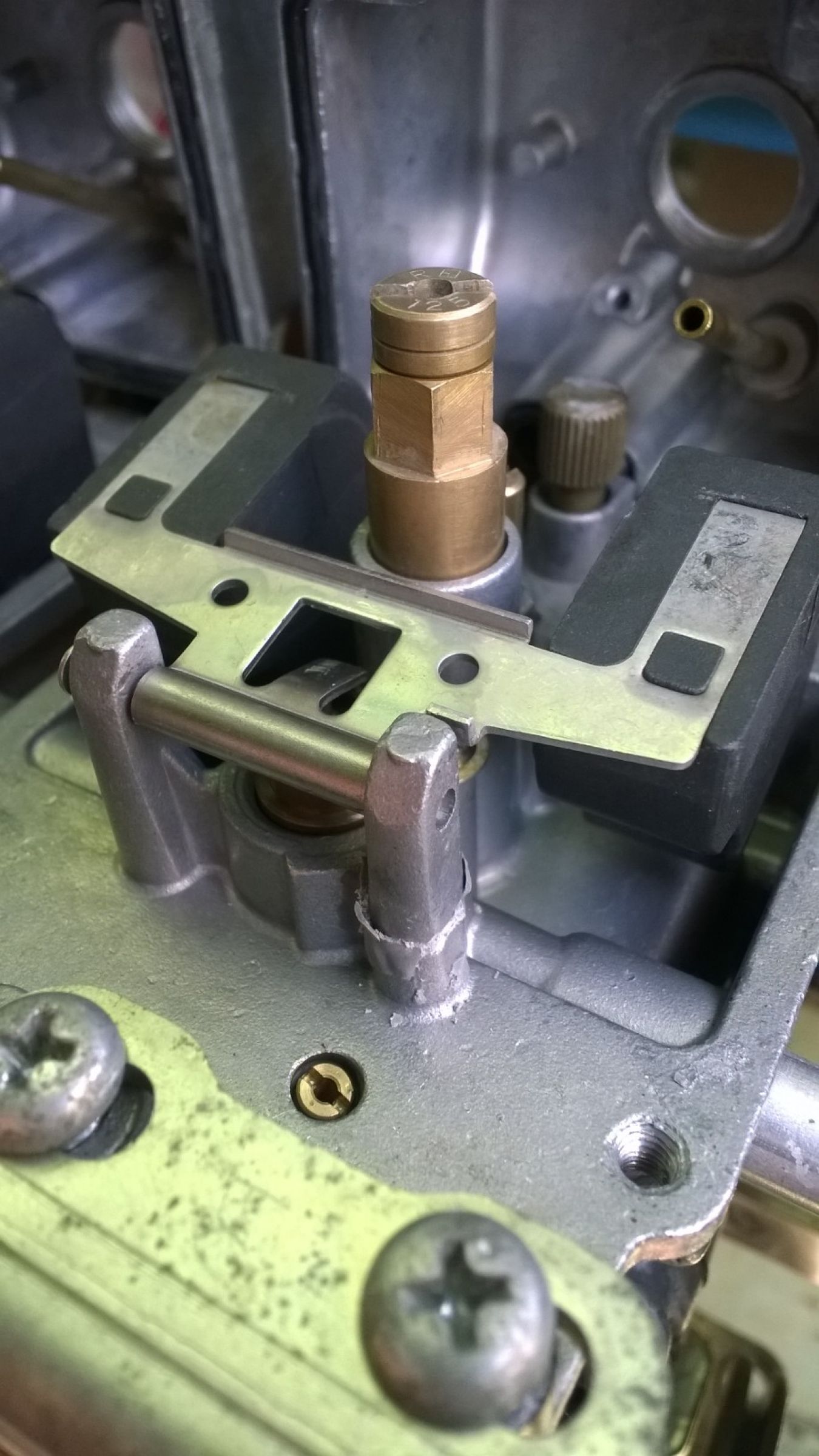

retterath wrote:
I also discovered that my JB weld float tower repair is not going to work. I tried the "fuel proof" JB weld first and it didn't hold. I didn't break them, by the way. B)
Any suggestions?
Just two cents, but I'd dowel it with a pin at the joint, combined with a rigid-set bonding material that will not be affected by fuel.
Added note: I see where your fuel level has been maintained by observing the overflow tube in the bowl, at the upper-right in your pic. The fuel residue-line confirms the clear-tube test level found in my carbs is correct, based on the Mikuni float level setting instructions.

Re: Expert RS36 Float Level Advice Needed Please!
01 May 2016 16:24
#723988
That's what I was thinking. Have to strip it completely to weld. :dry:

I have reset to 19mm, happy medium? Will have to do a wet test tomorrow, I've absorbed enough gasoline for one day. You can see in the pic how far I had to bend the tangs to get the level that low.
For the tower, I carefully drilled through and pressed in a piece of wire. Will it hold? I dunno, but it definitely won't go all gooey like the JB weld.
01 May 2016 18:35
#724012
I would use a roll pin. It drives in tight just like on your gas cap.

retterath wrote: I have reset to 19mm, happy medium? Will have to do a wet test tomorrow, I've absorbed enough gasoline for one day. You can see in the pic how far I had to bend the tangs to get the level that low.
Having the carbs jigged-up (off the bike) definitely makes the process easier, and I know what you mean about the fingers and gasoline.
To minimize that problem, I modified my plugs so the bowls can drain without having to be completely removed. A little gas gets left in the cap and on a couple fingers, but not the hands! :)
01 May 2016 19:29
#724026
swest wrote: I would use a roll pin. It drives in tight just like on your gas cap.
This is not a job best-done with a hand-drill and old drill bit. This repair would require extreme care and be best-performed on a quality drill press, with the carbs fixed properly in a jig. No guessing for results, because you will only get one shot to get it right, and must hit the bulls eye in the center.
01 May 2016 21:02
#724043
Actually, I used a hand drill and a brand new bit. Veeeeeeeeeery slowly. Carefully pressed a precision machined bit of piano wire in. Voila! Good enough for who it's for.
I did price new used carb bodies first. :) And a new rack of carbs.
02 May 2016 05:24
#724061
retterath wrote: Actually, I used a hand drill and a brand new bit. Veeeeeeeeeery slowly. Carefully pressed a precision machined bit of piano wire in. Voila! Good enough for who it's for.
:cheer: Steady and confident, even with the pressure of a potential fubar.
