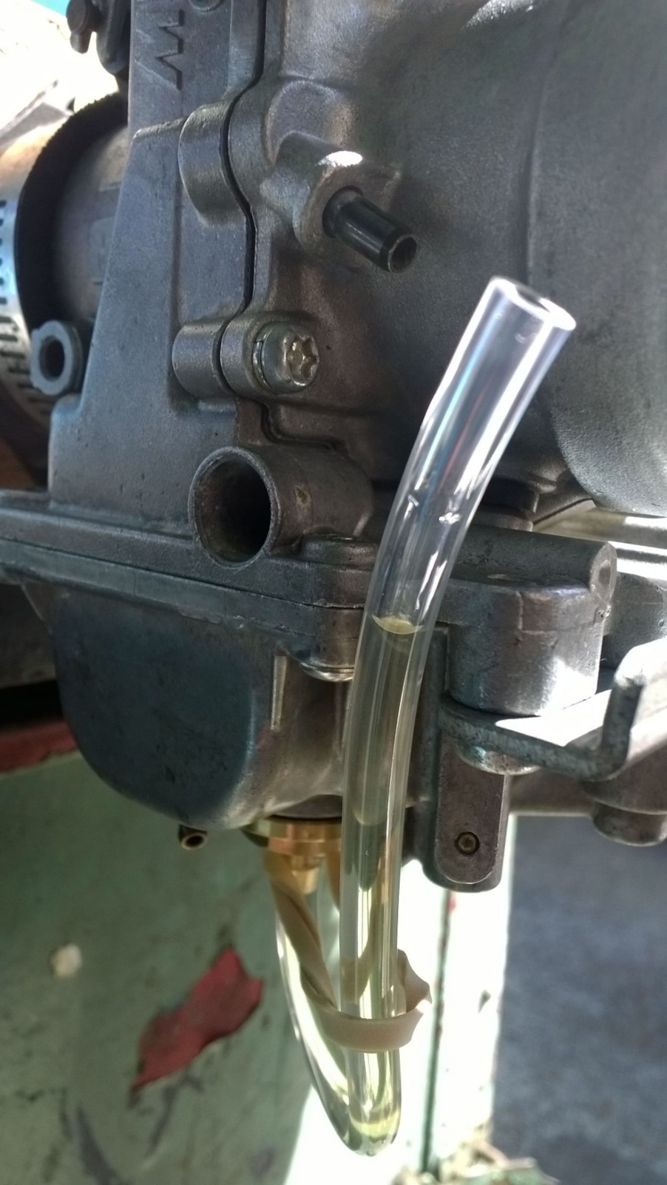

30 Apr 2016 08:34swest wrote: I'd set a reference point then set them all at that point with the clear tube test. Measuring them is like shooting in the dark.
That is exactly what I did, based on the 17mm spec instructions in the Mikuni tuning guide. The levels are all within 0.5mm of each other.
Should I ignore the fact that all the levels are 4mm-5mm above the top of the bowls, instead of below them, and assume that they are correctly set that way?
If so, then that means the "clear-tube method" instructions are either incorrect, or not applicable to the RS series carbs, because those instructions specify the level needs to be 3mm below the bowl tops.
Hence my current state of flummification. :blink:

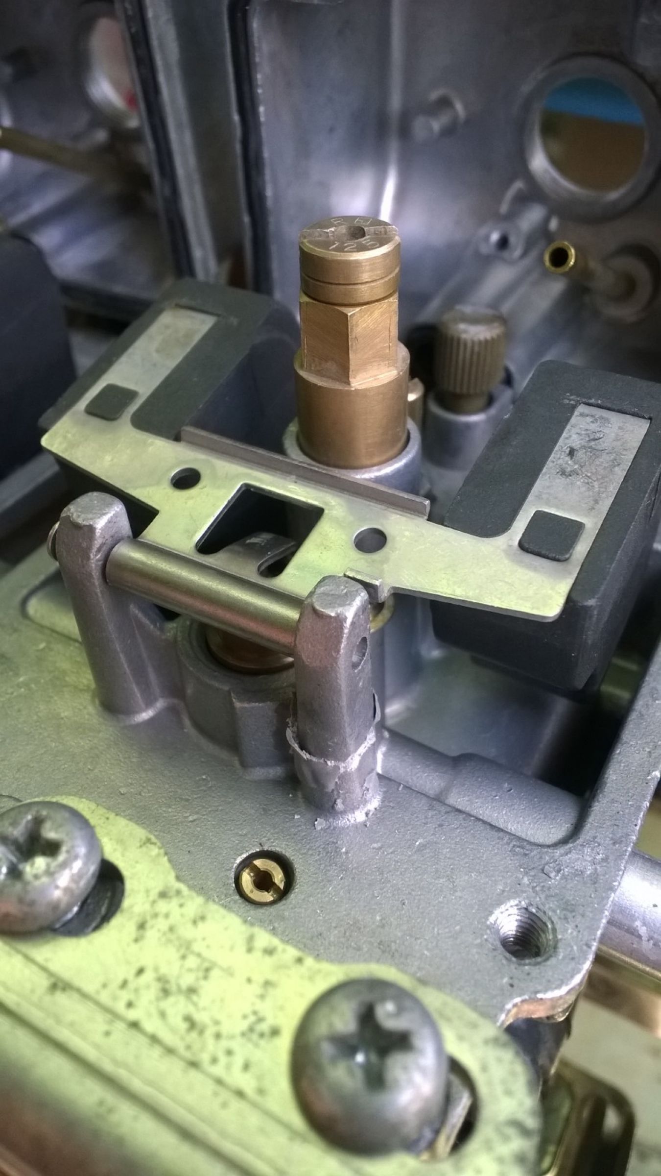

01 May 2016 12:56This is where I end up with the float set at 17mm. If i crank them down to get the fuel level as low as the instructions say, the tang on the float hits the seat first, and flow never shuts off. :huh:
Maybe 17mm is where it needs to be?
I also discovered that my JB weld float tower repair is not going to work. I tried the "fuel proof" JB weld first and it didn't hold. I didn't break them, by the way.
Any suggestions?

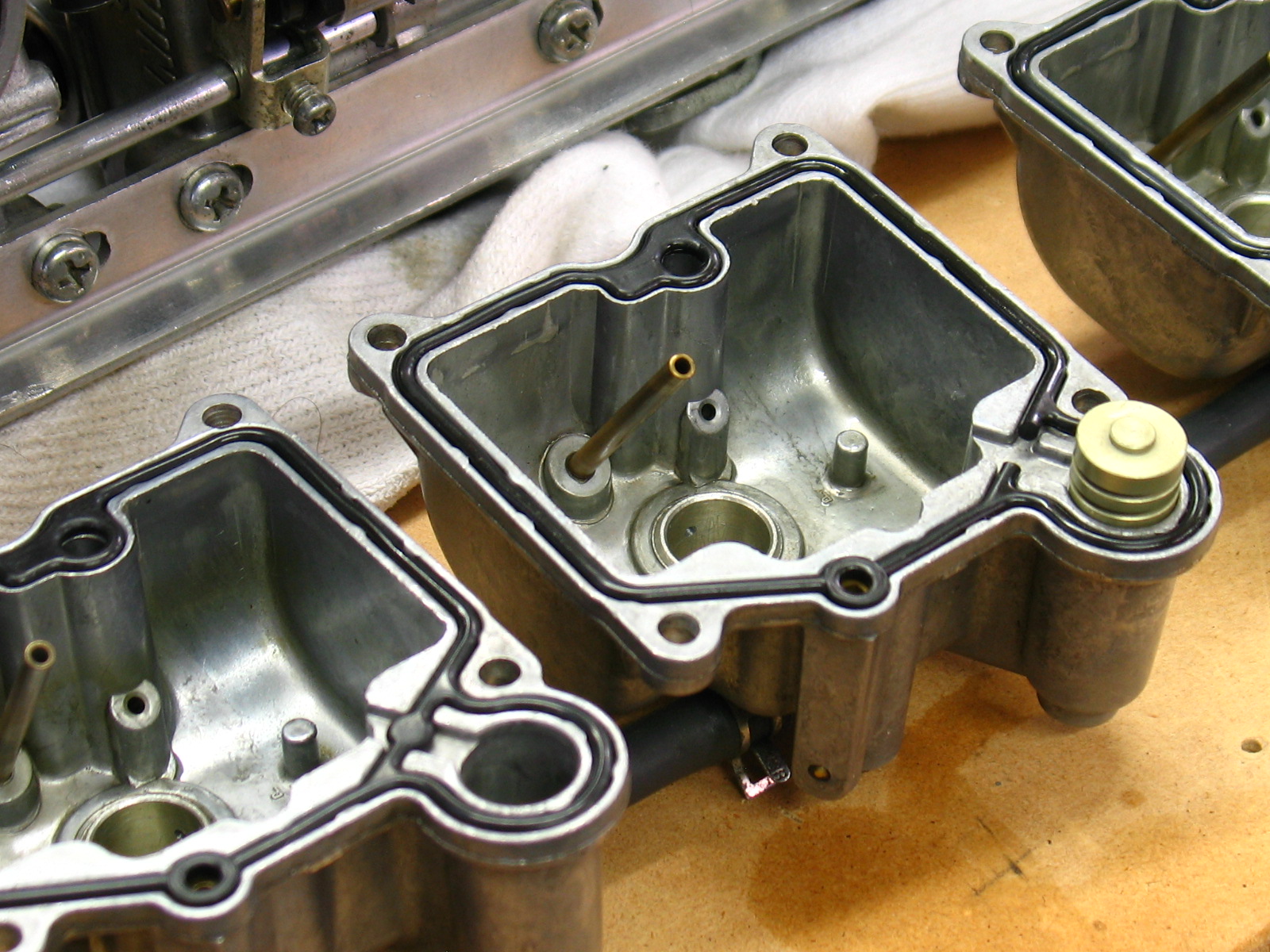

01 May 2016 14:37daveo wrote: Bought the tool...
Used the tool...but :huh:
All four are the same, 4mm - 5mm above the bowl mating surface. So, what's the deal?
I followed the owners manual procedure and carefully set the four floats to 17mm with the carbs upside-down...and this is what I get? :blink:
After thinking about it, maybe its supposed to be like that, since this set of carbs has a pump that squirts fuel into the bore, and the pump bowl gasket is cut next to the plunger...hmmm. Is that where the fuel feeds into the pump system, and if so then I think the fuel level needs to be above the bowl surface rather than below it?
Then what about the overflow tube? Fuel enters it at 6.5mm +/- above the top of the bowl, so I've got about 2mm to spare with the levels as-checked.
If it is supposed to be this way, then I'm rock'n baby! Otherwise... :S
Where did you get that cap for the clear tube method?
