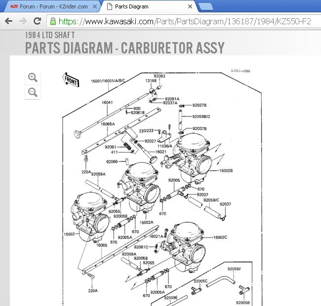

That is interesting. I did not know the shaft-drive TK26's had the side knob. It doesn't show that on the parts fiche.
When I look at it on the parts fiche, it shows a center knob.
This image is for the U.S. version 1984 Kz550F2 shaft Ltd.

Ahh, non-U.S. 550F
There are two ways to designate the models. One is the factory designation, and the other is the marketing designation.
Unfortunately, the marketing names overlap the factory designations in a confusing way.
The factory designation Kz550F is a shaft drive, cruiser model, known by the marketing name Spectre, or Ltd. Shaft. (depending on the year, 83 or 84, respectively).
The factory designation Zr550A is known by the marketing name Z550F. But that is not based on the shaft drive Ltd. It was actually based on the 82-83 factory designated KZ550H, which was known by the marketing name Gpz550.
However, there is still a chance the Kz550F had a side mounted idle knob since the Kawasaki fiche's are not to be trusted.
When I looked at the ZX550A (84-85 Gpz550), the carb diagram shows the idle knob in the center. That is definitely wrong.

Here is the 84-85 Zx550A (Gpz 550) carb fiche from Kawasaki's website. This is not correct. There should be a remote idle knob, not a center knob.

And here is a 1984 Kz550F shaft Ltd. It shows an idle knob on the side, as Wozza said. So it appears both (kz550F and Zx550A) parts fiche's may be wrong after all.
EDIT: Further searches show this to be a change made in 1984. It looks to be a simple bolt-on accessory change. The 1983 shaft carbs, in photos, have the center knob, as does the 1983 Kz550A4 standard Kz550, which also came with TK26 carbs.
