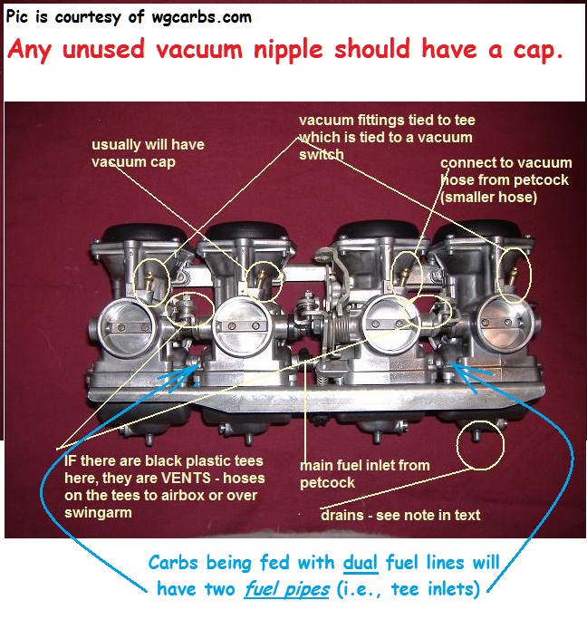

This image from wired george might possibly help with the carbs at hand.
If the hoses in question aren't from the float bowl vents, there should be other hoses that do connect to float bowl vents or at least other open float bowl vent nipples that have no hoses connected to them.

Also, make sure the bowl vent tube does not move. Secure it up under the area where the tank and seat come together.
I found out by accident, that if the bowl vent gets into moving air at high speed, it can really lean out a mixture... very bad at high speed / high load. I verified it on a wide-band o2 analyzer, and could repeat it by moving the vent tube to specific areas.
EDIT: looking back, it appears your capped tee is for the emissions valves, which are probably removed. Leave it capped.
Bowl vents will be anywhere above the bowls.
You can get the various manuals for that specific bike by following the links in my signature.
Yours looks to be an 83 Kz550 H2 Gpz. IT will be covered in the appendices of the factory manuals I have posted.
Also, it would help to put your bike in the signature so you don't have to keep posting what it is.
