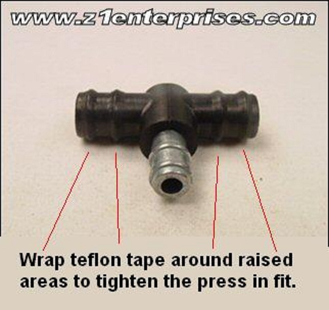

fuel pipe joint at Z1E
Or another option -- Might be able to tighten the joints by wrapping with Teflon tape (yellow is slightly more fuel proof than white).
If the leak in this area began after adding fuel to a carb that's been dry for quite some time, it might self-cure after a day or so exposure to fuel which sometimes allows the o-rings to swell a little, especially with a joint that has integrated raised ridges instead of separate o'rings.

02 Mar 2016 14:18Patton wrote: Click here > fuel pipe joint at Z1E
I don't know if any of the K650 models had the following style fuel pipe joints:
[See my subsequent post showing how members may add a specific model to their signatures.]
I ended up ordering that exact part. I don't wanna wrap it in teflon and find out it leaks again
