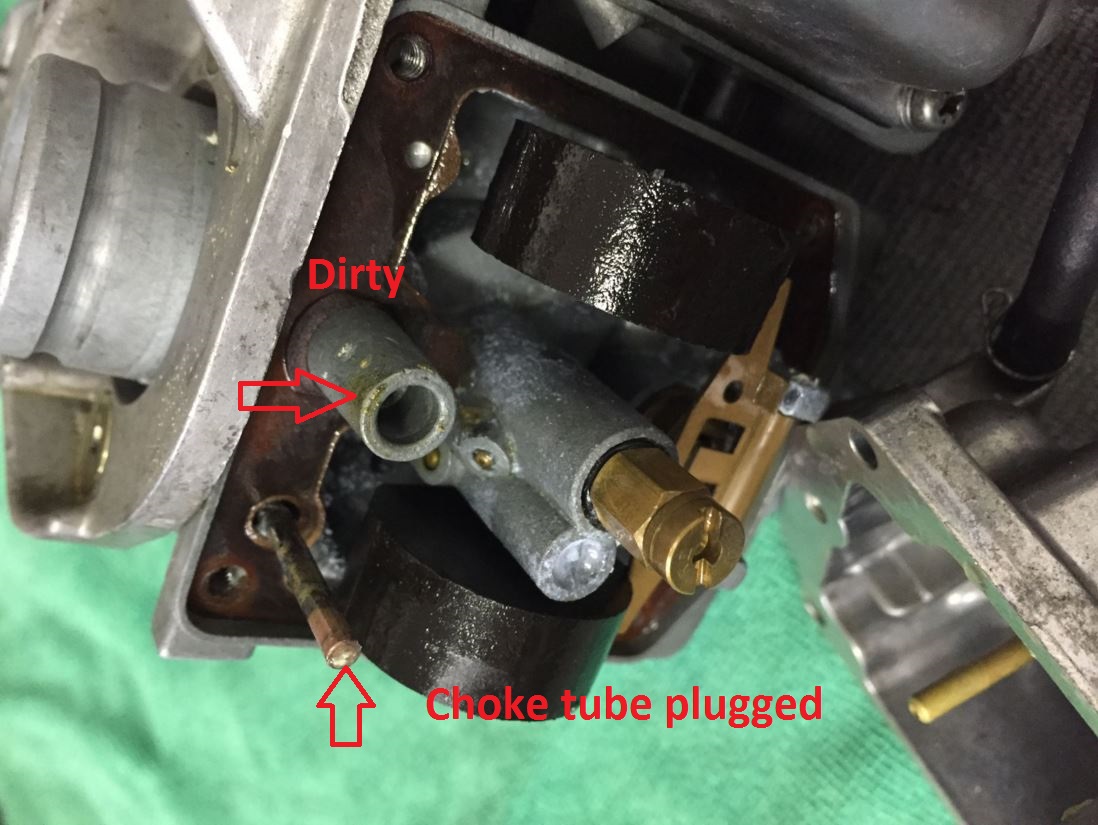

21 Mar 2016 09:00TexasKZ wrote: That white stuff looks like oxidized metal. If that is so, then it indicates the presence of water. Could you have gotten some bad fuel that caused all these headaches?
You know it's probably water. A few days ago I had rigged up my carbs and did the clear tube test but I didn't have any gas so I used water as an interim substitute. Float levels seemed normal (around 1/8" below top edge of bowl). Which is kind of a head scratcher because that means the culprit to this fuel overflow issue I'm having is probably elsewhere.
Well another novice mistake under my belt.
Appreciate the pointer though TexasKZ!

21 Mar 2016 09:08Nessism wrote: The choke tube looks to be plugged up for one thing, plus there are chunkies visible. I'd ungang the carbs and tear them down. Soak in carb dip and replace all the various O-rings. Cycleorings.com sells a VM kit which should have most of what you need. You can supplement with some bowl gaskets as needed from Z1 Enterprises or similar.
Short cuts are long cuts when it comes to carbs.
members.dslextreme.com/users/bikecliff/i.../vm_carb_rebuild.pdf
Thanks Ed. That PDF is a great play by play. Blows the Clymer out of the water.
Cheers!
