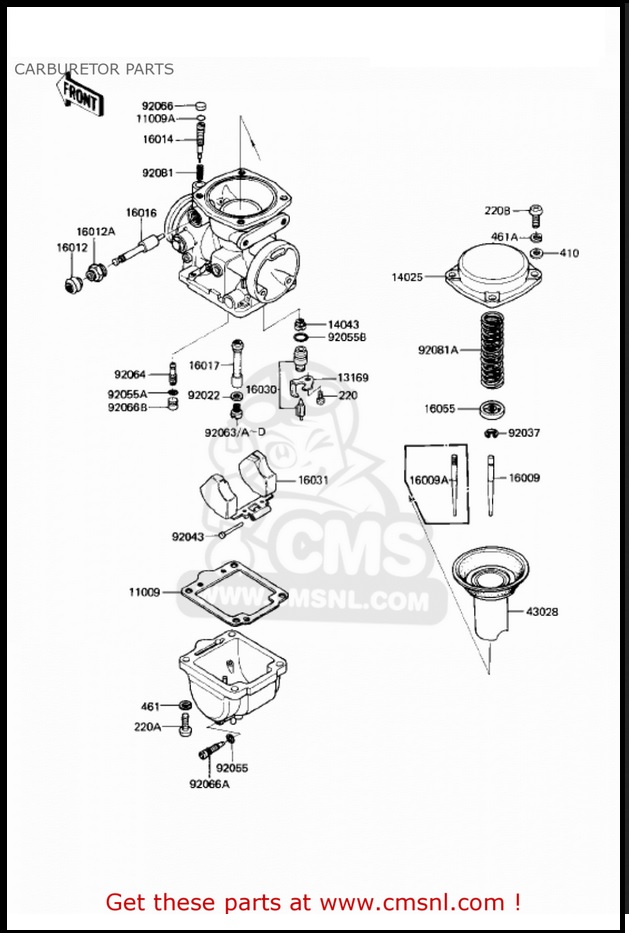

25 Feb 2016 22:21 - 25 Feb 2016 22:2116014 Part of the picture, what is its function?
When I'm bad at English fakt terms so please use simple language
Thanks L
Air-fuel mixture screw for tuning pilot circuit.

27 Feb 2016 00:58 - 27 Feb 2016 01:00Thank you for an answer to my home language, wonderful!Patton wrote: 16014 Part of the picture, what is its function?
Luftbränsleblandningen skruv för avstämning pilotkretsen .
Both of these air screws were closed when I took off and rengorde carburetors .... I opened them only 1/2 turn and now 1/2 turn more!
The bike goes like a shot, great engine .... In the lower gears (first) and secund gear so the engine putters a little, when accelerating from idle to 2000 rpm (the same in first gear even if it does not affect and interfere as much, but it's there)
I have checked and sealed all the carburetor page:
Clean, washed and blown all the channels and nozzles.
Checked vacum membranes OK
All vacum hoses OK
Dismantled, checked and cleaned intake rubbers OK
Adjusted balance between throttles OK
Tried to lower the float needles one level (much worse)
Raised needles (as it is now
So? What should I listen for when I screw those screws?
Do I need any instrument, tool?
Or should I just enjoy as is
Thanks for the replies Lucas

Perhaps the mixture screws need to be turned out a bit more. They should be set to achieve the highest idle speed (rpm), then the idle rpm should be reset using the idle speed adjustment knob.
Have you checked the fuel level in each carburetor? It can affect other adjustments, so it should be checked before adjusting the needles or mixture screws.

TexasKZ wrote: Perhaps the mixture screws need to be turned out a bit more. They should be set to achieve the highest idle speed (rpm), then the idle rpm should be reset using the idle speed adjustment knob.
www.kzrider.com/jdownloads/General/Gener...clear_tube_combo.jpg
Fuel level in each carburetor. Check
I will do as you describe with idling.
Many thanks!

On my 750 twin, the best set point is about two turns out from all the way in on the mixture screws. The stock pilot jets are #45, but you can go up to #50 and it will run better. This advice assumes everything is stock and there are no problems like air leaks.
