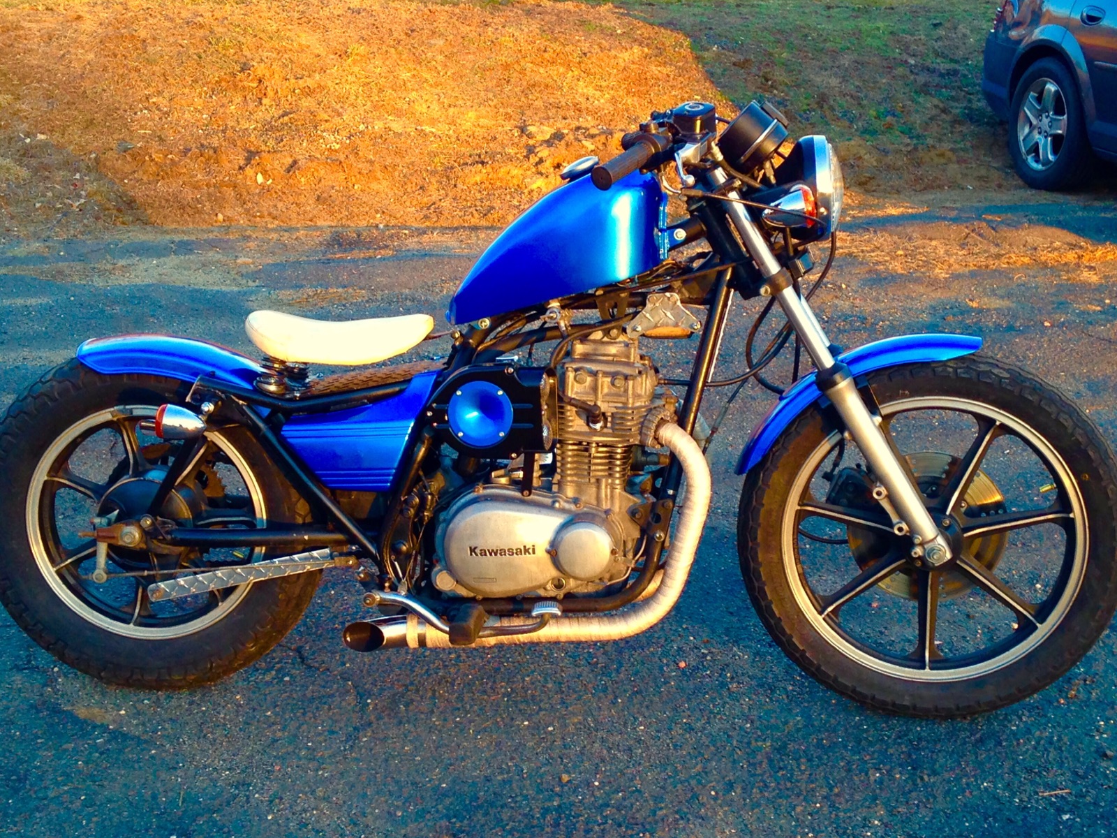

bike is still a project right now and nothing is painted but here are some pictures of the hypercharger i mounted and plumbed it to both carbs

While that may "look" cool those CV carb's are gonna hate it.
Once at speed when the ram air effect kill's the vacuum signal and blow's the slide's shut.

ive done many carb mods and have it dialed in prety well in order to run the hypercharger and already test riden the bike with the hypercharger on it and it runs beautiful

took 7 months but the bike is finally done now

Nice job! Great shade of blue.

08 Mar 2016 19:01Mwilcox996 wrote: took 7 months but the bike is finally done now
Aluminum deck plate does not make for a very good brake rod.

09 Mar 2016 06:24 - 09 Mar 2016 06:38Aluminum deck plate does not make for a very good brake rod.
maybe the stock torque link is hidden behind it. or maybe it's steel.
If it wasn't done, consider replacing the rear brake shoes if their age is unknown. The adhesive that binds the linings to the shoes can fail over time, so a lining can come loose and get jammed between the shoe & drum, locking the rear wheel. it happened to me, so it does happen. doh.
