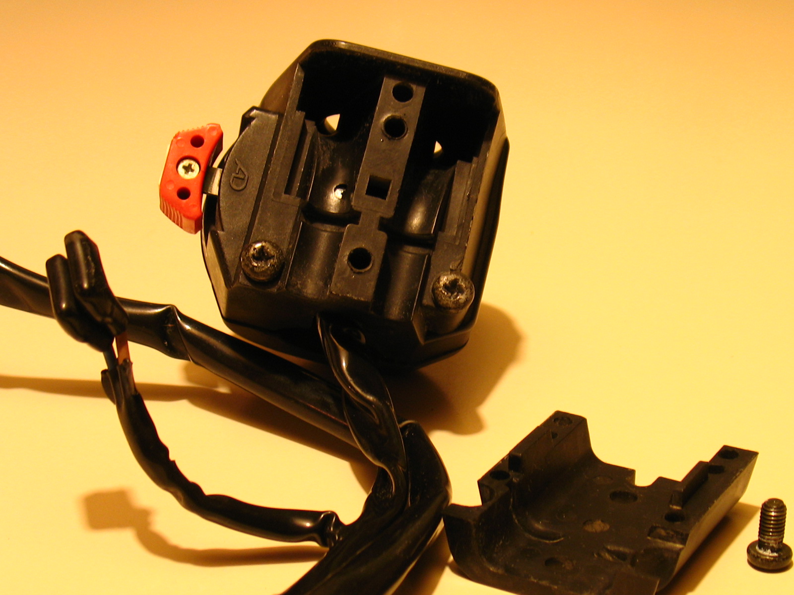

Thinking ahead to a set of Mikuni Flat Slides, I purchased the Kawasaki push/pull control pictured below, and figure I'll need to swap the wiring connector. I've got the correct throttle grip coming, but...

The control cleaned up pretty well...definitely a dual-cable unit.

I can't figure out why Kawasaki made the dual-cable control for the 84-85 ZN1100's, but I did figure out that it's wiring loom is about 4" shorter than the KZ1100-A2. :ohmy:
So, while contemplating the situation it hit me upside the head that maybe (just maybe(?)) the switches would interchange from one control over to the other. That way I could swap the entire looms, instead of patching wires or swapping connectors over...
Joly crap...! Sure enough!!! :woohoo:
Wow, that was easy, and the big old rounded top cap wasn't necessary either since the old cover cap fits perfectly on top of the dual-cable base control unit,
