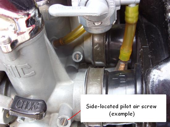

Possibilities could include issues with insufficient valve clearances and/or imperfect pilot circuits.
Are the carbs manual slide with side-located pilot air screws, similar to the following?
- strum
- Posts: 197
- Thanks: 7
Re: slight stumble at take off could use some advise
02 Feb 2016 17:50
yes they have the air screws on the side much like your photo. They are the VM 28mm pumpers that came stock on the bike.
I just adjusted the valves so i feel thats ok.and the carbs have been apart and cleaned not only buy me but i took em to my friend because some of the pump parts were missing and he cleaned and checked all the circuits also.
