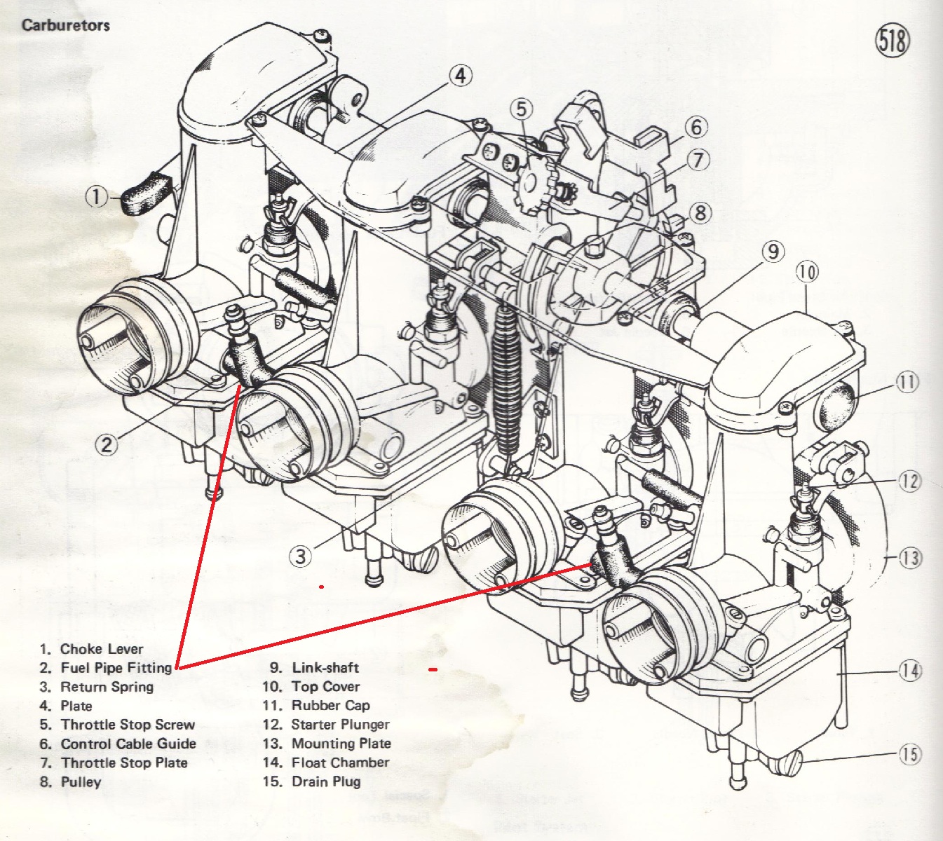

The stock Mikuni 26mm carbs on 1976 KZ900-B1 LTD -- see image below -- are fueled with dual fuel lines from the petcock which fuel lines are attached to two fuel inlets (i.e., fuel pipe joints).

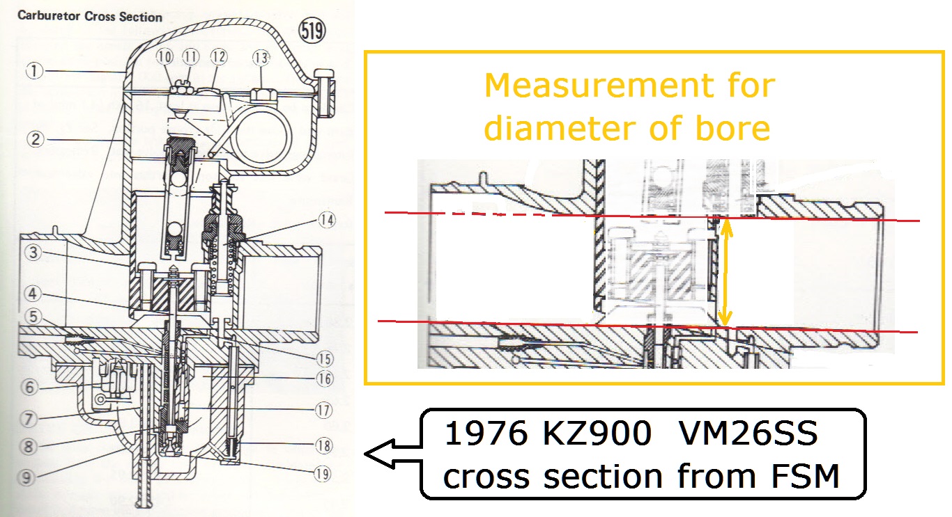

The carb size may be measured as inside diameter of the main carb bore on the engine side, which is slightly over 26mm on a 26mm carb, and slightly over 28mm on a 28mm carb.
Am thinking that both the street model KZ900-A and LTD model KZ900-B used the same 26mm Mikuni carbs.
