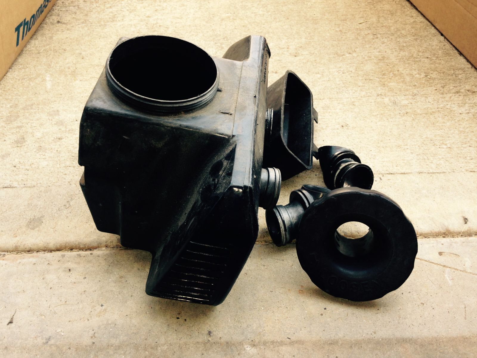

The guy I'm talking to (revboyz) has a 1984 700 he has the air box and a Vance and Hines he says they should fit, but I'm not sure.

20 Jan 2016 02:11 - 21 Jan 2016 01:52The 700 airbox is the same as the 750-4. if you don't have the correct ducts, none of them will work with VM24 carburetors.The guy I'm talking to (revboyz) has a 1984 700 he has the air box and a Vance and Hines he says they should fit, but I'm not sure.
BS32 carburetors from an 82-83 650-CSR could be installed, but you'd need the 750 carb holders & airbox ducts. I don't know if there would be fitment issues with the airbox.

You might be able to install a 750 airbox & ducts, then cut donuts from radiator hose to make up the difference in diameter, fitting the donuts onto the vm24s. you'd have to use 2 donuts per carb & ss band clamps. Assuming a 750 airbox fits your 650 frame, this could be an option.

Looks like I might have an airbox lined up from spdygon. Now just for the exhaust..
