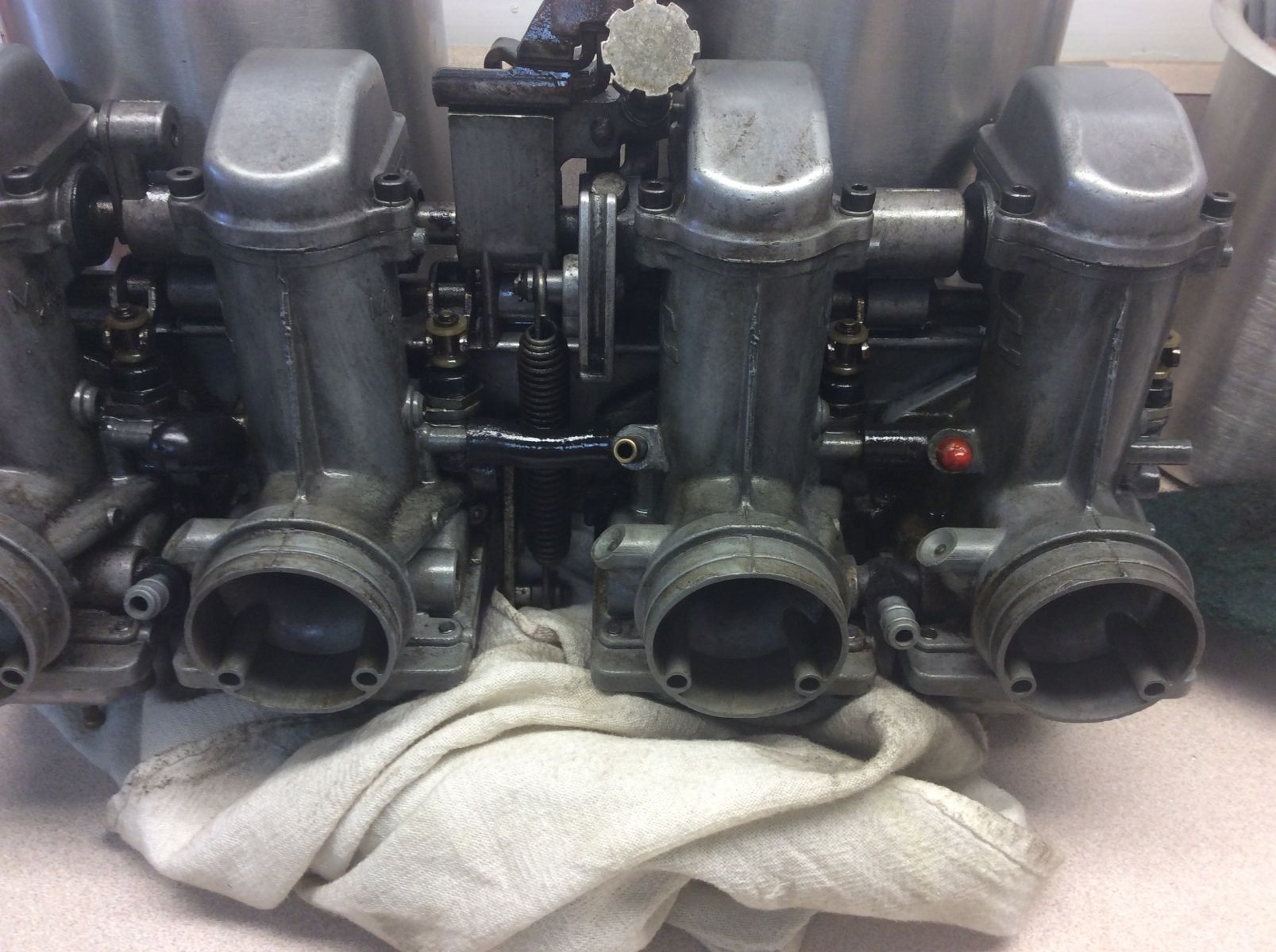

Ok I'm wanting to put 1978 carb rack on my 1977 kz1000 26 mikuniis on both,

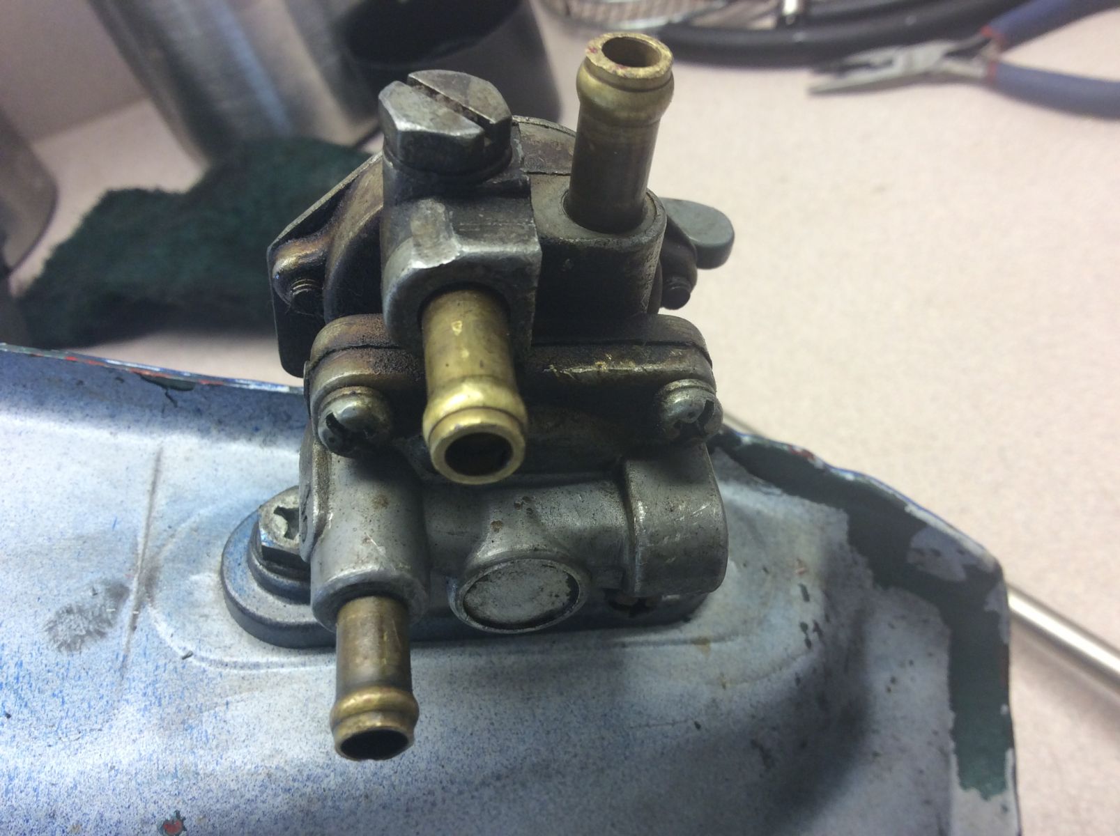

I believe the only difference that I see is the 78 had the vent tube from the fuel tap to carb 3 vent tube. Can I just cap the carb 3 vent tube? With out any performance issues? I added pics the petcock is the 78 tank which I don't want to use. I want to keep my matching body set the 77 has only the two outlets for gas on the pet cock. The carb pic is the 78 carb rack the carb 3 vent tube is uncapped one. Thx in advance..

I'm pretty sure you can cap that. Wouldn't hurt anything to try it anyway.

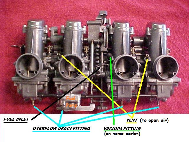

There are usually two vent nipples that serve all four float bowls.
Some 4-carb sets have a fifth separate vacuum nipple to serve a vacuum-operated petcock.
If the vacuum-operated petcock is replaced with a manual petcock (not requiring vacuum), the nipple should be capped/plugged, same as the other four vacuum nipples on the carb holders (that are used for carb syncing).
An unused vacuum nipple should always be capped/plugged during normal operation.
With engine running, be sure there's not an open vacuum nipple.
In the following example, the green line points to a vacuum nipple that should be capped/plugged unless it has a hose to a vacuum-operated petcock.
Absent vacuum being supplied, a vacuum-operated petcock is not supposed to flow any fuel in ON/RUN or REServe positions.
A vacuum-operated petcock is supposed to always flow fuel in PRIme position (which doesn't need vacuum).
