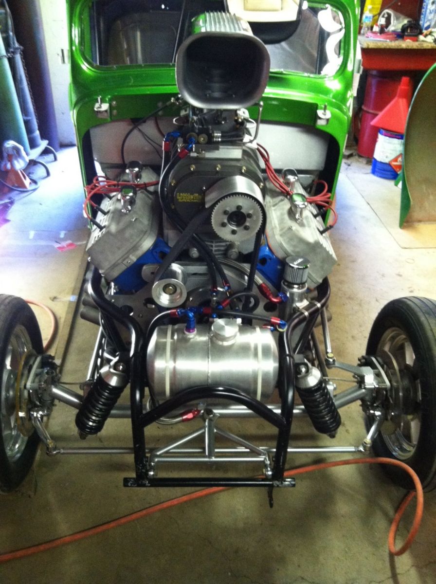

Is your local gasoline cut with 10% ethenol? Like New York state. This methenol we run in the AA/Gasser. Has to be cleaned out while sitting if it sits longer than a week.
It will turn into a sand like substance. Marvels Mystery oil helps, along with a PTFE blower lube. I f it sits longer than 1 week.
Maybe it is a sealer in the tank?
Clean it out and start over with an inline filter.
