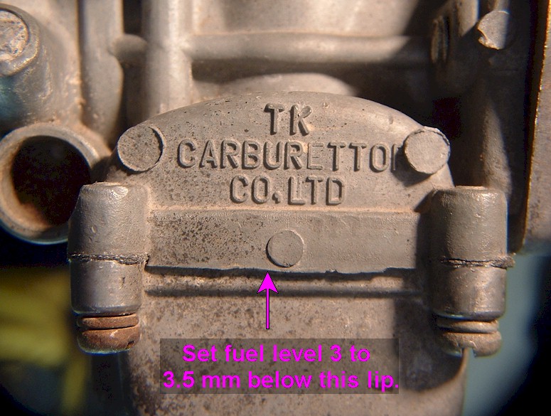

Hi all,
I am a little confused and looking for clarification. I was checking fuel service level on my tk22 carbs (550 LTD) because I was having some rich symptoms when snapping the throttle open. What I found was they were set where I intended to set them - but I am not sure this was correct. The picture with the pink arrow is from Loudhvx's website and it says to set the level in respect to the lip (which confuses me some, the lip is a little jagged and such). The other picture is my "as found" fuel level - which you can see I set in respect to the bowl/body mating surface (I hold the hose not in the middle of the bowl, but by the bowl screws), not the lip. From my photo, would you say I am too high fuel level? (my markings are exactly 3mm inside to inside of the markings).
Thanks.
Thanks.

I would be setting your fuel level at slightly below or near to the lower purple line on your clear tube

I in fact did lower them all to about equal to the lower line. Just wanted to clarify before I go further. My new intake boots make installing the carbs quite a chore.

My 81 kz550 is set closer to the bottom purple line you drew. I found the carbs would leak out of the overflows if they were set any higher

FYI. Use the meniscus as the reference point. The fuel forms a U in the clear tube --- the fuel level should be set in relation to the bottom of the U.

Excellent. I should be in good shape then. Hopefully this high fuel level is what was causing my rich condition that would cause a momentary bog when I snapped the throttle from 1/4 to 3/4+.
At the setting I have picture here, I never had an overflow, but sometimes it would weep if I had it on the center stand and then put it on the side stand. I'm guessing it was at the ragged edge of overflowing.
