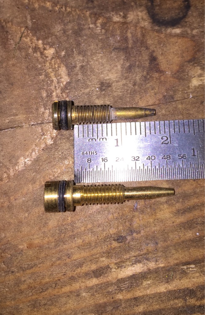

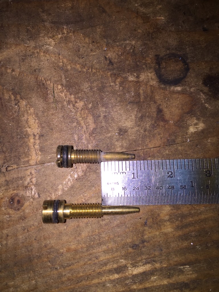

Ok took 2 pics side by side. One you'll see I zeroed them at the base of the head. The other at the end of the threads. Either way the rebuild kit one looks different.

Anyone have any thoughts on these pics? Same screw? Wrong screw? I threaded one in and for it to be the stock 1 3/8 turns out it felt kinda loose - like it might vibrate its way out.
