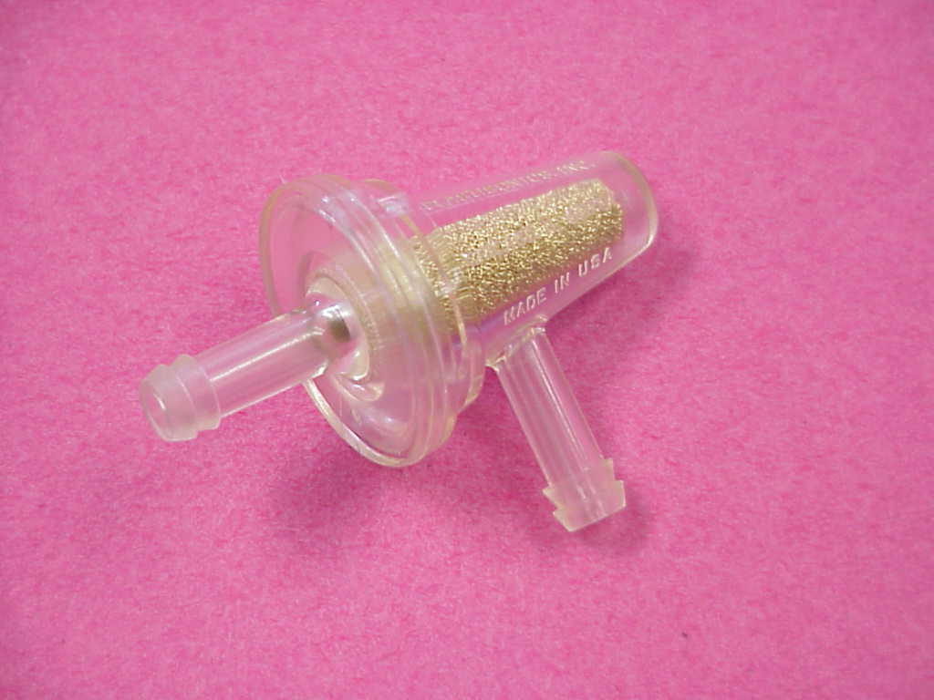

I don't want to hijack this thread but I bought one of these recently. Does anyone know what direction the fuel is supposed to flow? There were no instructions at all.
Attachment emgo.jpg not found

The fuel goes in on the side without the threads. Should be a arrow.

13 Sep 2016 14:54 - 13 Sep 2016 15:07bl_francis wrote: I don't want to hijack this thread but I bought one of these recently. Does anyone know what direction the fuel is supposed to flow? There were no instructions at all.
This looks exactly like a clone of a cool little blue anodized body sintered metal filter element I had back in the 80's on my hot rod 66 Mustang, sold by Russell performance products. The long end is the inlet, the short end "cap" went to the 6 mpg Holley 650 double pumper sitting on top of the ported Edelbrock Victor Jr. intake manifold...er, I mean your carburetor inlet...,damn I miss that car - yes, you can do wheelies with four wheels!
That way the filter presented a much larger area to the incoming fuel and didn't plug up as quickly. The element can be washed with solvent and blown out with compressed air from the "cup" side of the filter.
